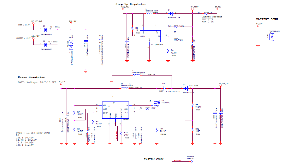

One of customer wants to make LEAD ACID Battery Charge / Discharge circuit as attached.
Could you review it and let me get the result?
  1. LEAD ACID Charge  : Step-Up Regulator : LMR62014 out  13.3V
  2. LM3481 out  12V  to System power
  3. LM3481  Power off if Vin drop under 10.7V

    Please find below my comments on LM3481 SEPIC design :

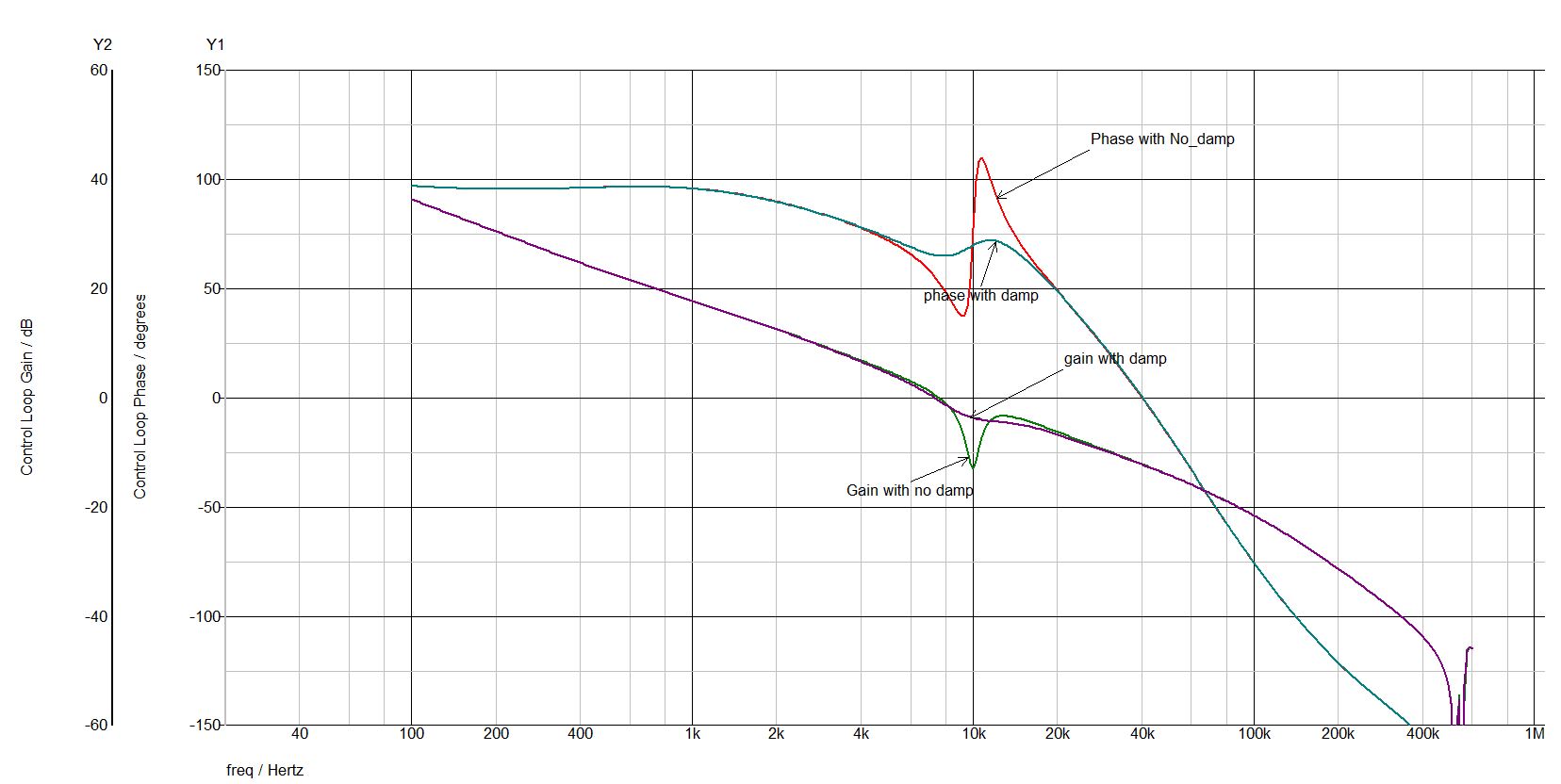

    1. With the uncoupled inductor in SEPIC , the measurement of the loop gain will show a high-Q , low frequency resonance which will need addition of an R/C damping filter in parallel with AC capacitor C6(in Schematic).The resonant frequency, while greatly simplified, appeared to be approximately
    The R/C damping needed to be placed parallel to  Cac cap C6 is series combination of 47uF/25V and 6.8 ohm .Below is the change in gain and phase you would see with the insertion of damping components .
    2. Rest all seems OK to be .
    --Ambreesh

  • Hi Nicky ,
    The RC damping filter is used to filter out the LC resonance happening at 10KHz approx in your design . You may use electrolytic Cap for damping C with positive terminal being connected to FET side and the dissipation across the resistance is smaller than 100mW so 0805 or 1206 should be OK for the design . The other option is to use coupled inductor for the design . You may find more details here
    www.ti.com/.../slyt411.pdf
