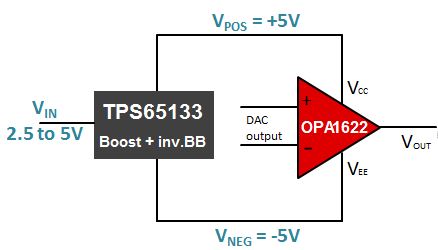

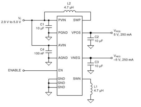

One of customer facing a problem of TPS65133.
The Neg. voltage of TPS65133 cannot down to -5V.
Input: 3.3V
VPOS: 5V
VENG: -4.4V
The output of TPS65133 is several OP.
