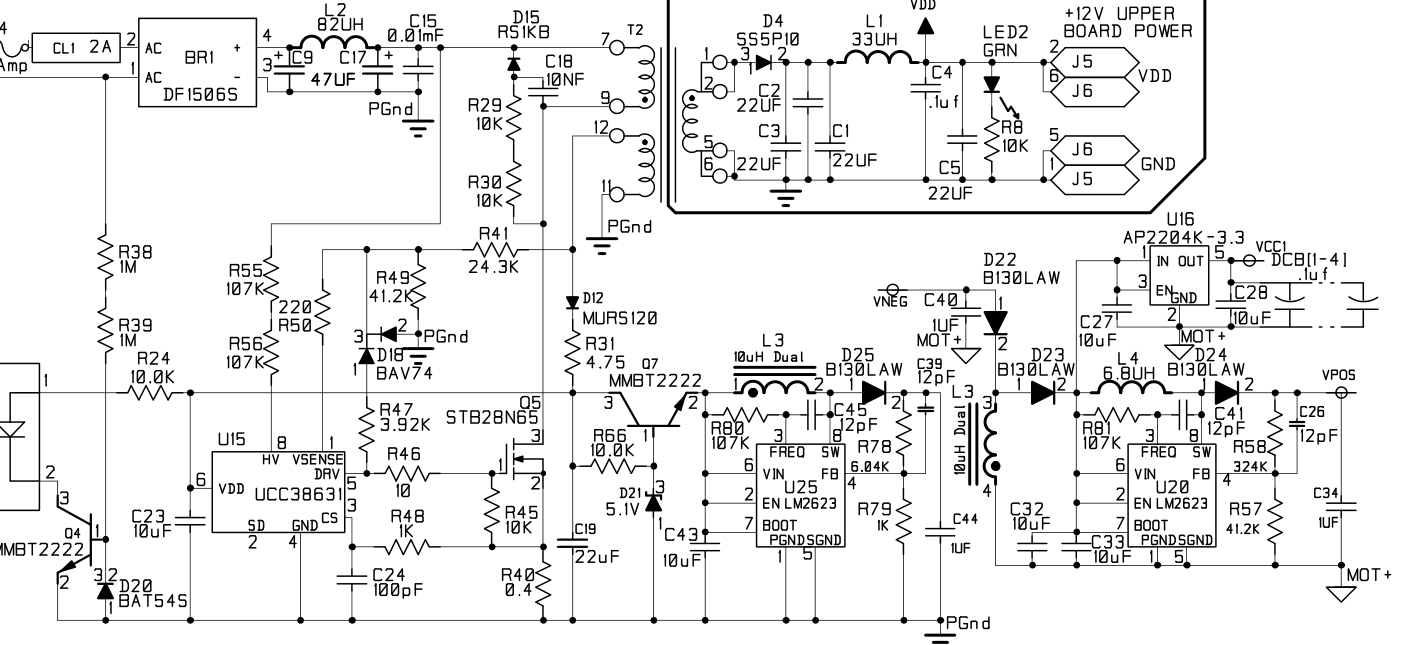

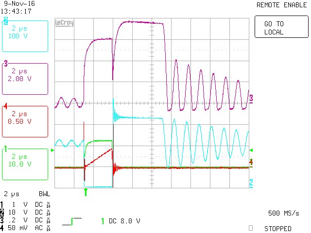

I have a 550uH 8:1:1 transformer with 10% max leakage, Rp=3.92K, Ra=24.3K, Rb=47.5K and Rcs=0.4
output target is 12-15V (not picky since it replaces an unreg supply) at 36W (also not critical)
the chip error code varies between VDD low and Vbus low at 150V bus under no and low load
seems like the only things amiss from the forums is bringing it up slow and a standard RC clamper
any thoughts while i try to rig a 200V clamp?

    Can you post your schematic, Excel design calculator (if used), and some waveforms? In particular, what output preload resistance are you using (provides the necessary minimum load when external load is zero), and what series resistance do you have in series with the bias rectifier diode?

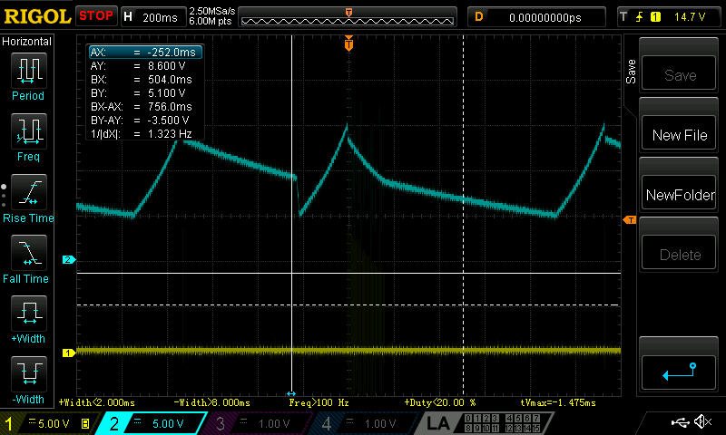

    buzzes at around 100hz sometimes and quits ... error codes either low vdd or low hv ... (those codes should be on the data sheet: makes a lot more sense when you know why it does not start)

  • Dan
    If you follow the steps posted by Ulrich, you can post attachments when editing in Rich Text Format.
    Please try to post the schematic and waveforms of VDD, DRV, AUX (anode of rectifying diode), CS, both at a slow time scale showing the VDD charge/discharge cycle, and then also zoomed in at say 10 us/div around the point where VDD reaches ~15V and the first PWM pulses are generated at DRV - you can trigger on DRV.
    One possible suggestion, can you check/verify the correct aux winding polarity? If this is reversed, then the controller will not start under any input voltage level, it will always get interpreted as UV on the bulk cap voltage.
    Bernard
  • USE RTF ... DUH  lol
    I had checked and rechecked the polarities and all are correct per the documents, and seem to be correct in the traces, unless i am misinterpreting them.  The numbers i used do not seem to make the spread sheet crab about it ... at least not for the UCC28631
    R24, 66, Q7 are out of circuit -  i missed the fact that the start up current is virtually non existent so i will be forced to tap off before D12 for that power

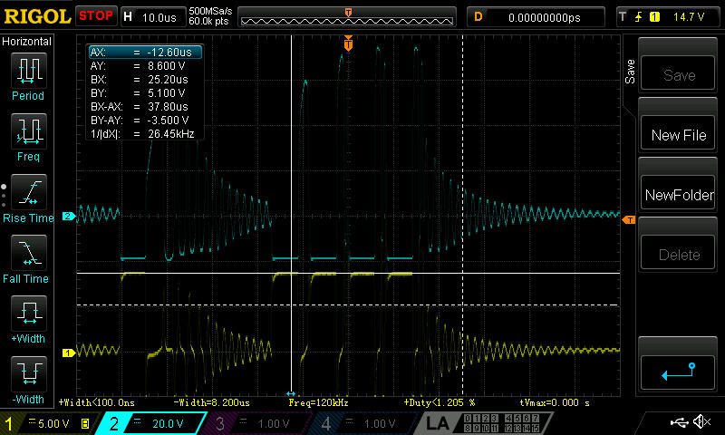

    VDD cycles from the 5V reset level to the 15V restart level though it is different depending on if the error reported is VDD UV or AC UV
    the aux pin is "reading" 160V on the AC bulk capacitance and 80V peak on the secondary ... i might have to go back and check the diode and caps as well

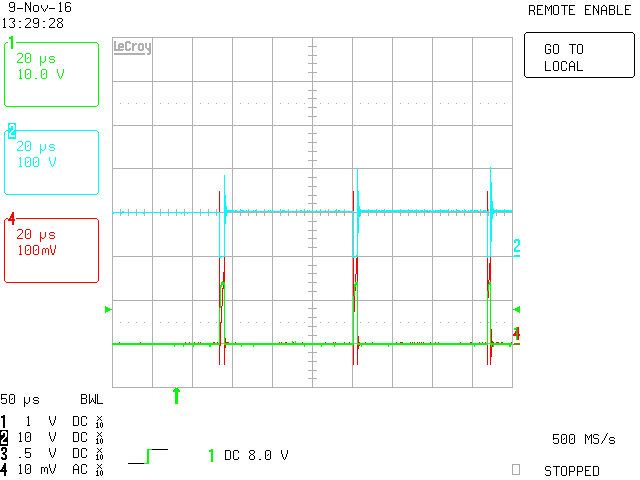

    there is a lot of pickup on the scope because i did not bother with clean connections.  called the supplier and the saturation current is close to 4A on the transformer design
  • Dan,

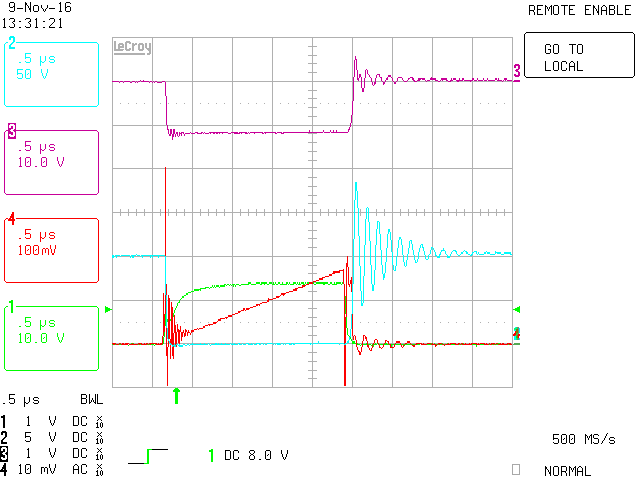

    Can you tell us what are the yellow and blue waveforms? I am guessing that yellow is DRV on both lower plots, and blue is aux winding on the second plot, and cS pin on the third?
    They are also quite hard to see, can you post plots on a white background, or turn up the brightness/contrast to make the waveforms easier to see?
    Bernard
  • you are correct about DRV being the lower yellow... those are scope generated "screen shots"
    cant redo them now... removed the sample transformer to give the board to the software guys... I am going to be measuring the inductances as best i can with the equipment i have and building up the regulator on a bare board to continue struggling with it
  • Dan
    Thanks for confirming my assumptions above the waveforms above.
    I see that the "flyback" portion of the aux waveform looks rather strange. The voltage rises very slowly/softly after the primary FET turns off, so when the aux winding sample of the output voltage is taken, it will appear low. As a result, the internal control loop will increase the demand level, and set a higher peak current and freq - as is seen in the subsequent cycles, where the freq increases a lot.
    I think that the RCD snubber may be causing issues - the cap value of 10 nF is very large, and recharging this cap when the FET turns off could be causing the very slow rate of rise on the drain voltage - typically the clamp cap is more like 470 pF -1 nF, with much larger resistor values to achieve long time constant (several switching periods at least). I would suggest initially running with the snubber disconnected - at low line, the Vds stress on Q5 should be ok, at least at light load.
    If this addresses the issue and allows the power supply to start up and run, then the snubber design can be addressed. This TI/Unitrode Power Supply Design Seminar paper is very useful:

    - loading VDD of UCC28631 directly (R24, R66, Q7 etc) is not a good idea, as you already discovered - this will at least slow down the charging of the VDD cap at startup, but could be so severe that it prevents VDD from charging at all to the start level.
    - as you noted, supplying R24/R66/Q7 from a dedicated rectifier on the aux winding will be a better way to go, so that this rail only powers up with the main output, and does not load VDD during startup
    - having extra loading on the aux via Q7 etc may cause issues with output regulation at light load - effectively there would now be a dual output, main 12-V and aux 12-V, with consequential cross-loading effects - if the load on the main 12-V is very light or near zero, while the aux 12-V rail is more heavily loaded, the main output will tend to increase due to leakage inductance energy pumping up the rail.
    - the main FET Q5 seems quite large for 36-W power level - STB28N65 is 180 m-ohm which seems overkill - this will have much higher capacitance and gate charge than a higher resistance FET, and will have higher switching losses, esp at high line. The EVM uses ~380 m-ohm FET STF13NM60.
    - the gate pull-down resistor R45 is quite small, 10 k-ohm. On the UCC28631 version, that resistor is used to programme the desired CC-mode limiting level as a % of the max capability of the design - see page 39 of the datasheet. A 10 k-ohm pull-down will programme CC limit ~75% of max capability. This may or may not be an intentional value.
    - the preload resistor value of R8 (10 k-ohm) is quite large - for 12-V output, this represents just ~12 mW of pre-load power, which may not be enough to ensure regulation at no-load.
    - the RCD snubber would be better implemented with the diode D15 connected directly to the drain of Q5, and then connect the RC between +Vbulk rail and the cathode of D15 - this will minimise the total area of PCB traces and components that are switching up/down at HV/HF, and help minimise CM noise.
    - The 2 x 107 k-ohm resistors (R55, R56) in series with the HV pin can be reduced to get more VDD startup charging current and faster startup. These resistors need to be kept quite large on the UCC28630 & UCC28633 so as not to saturate the internal startup current source, to facilitate the X-cap discharge feature. On the UCC28631/2 that feature is not present, so the resistors can be made smaller – the only consequence is that a larger portion of the startup charging energy will be dissipated inside the UCC28631 package when the resistor values are reduced
    - Are the LM2623 devices and the dual inductor L3 being used to generate isolated rails? Since they seem to be derived from a 5-V rail which is in turn derived from the 12-V aux rail, would it be more efficient to generate these from extra separate secondary windings on the main Flyback transformer?

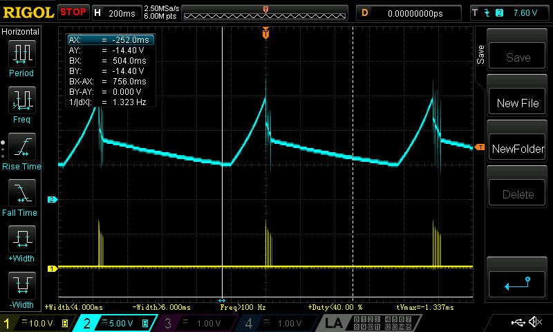

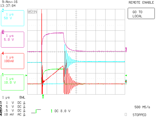

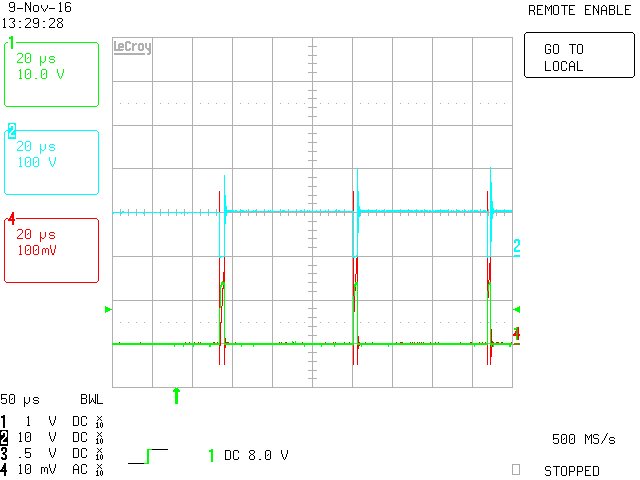

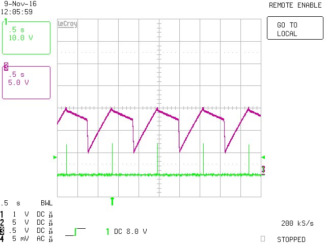

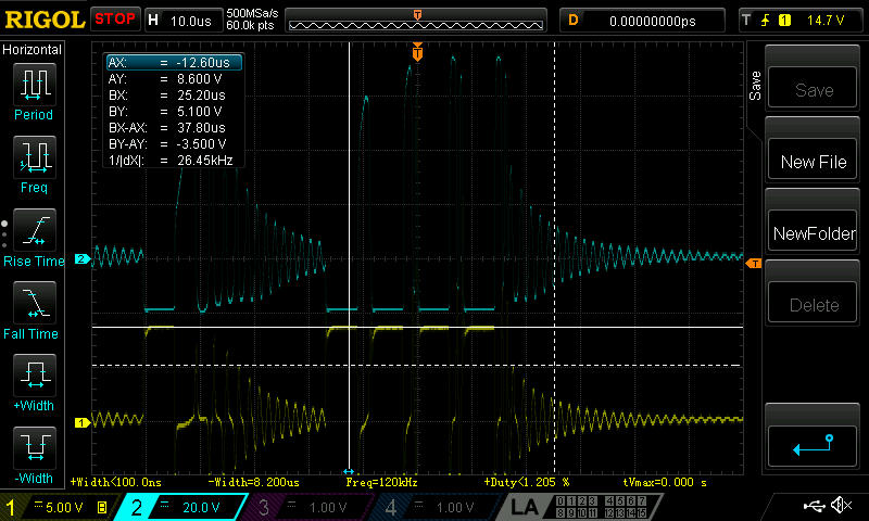

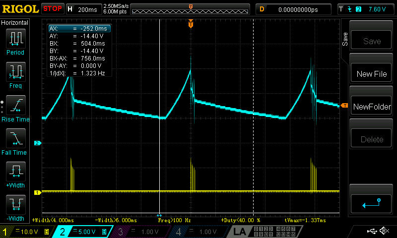

    These are waveforms I took on another EVM, at input Vin = 100 V dc.
    This shows VDD (pink) & DRV (green) during repeated restart attempts; each attempt is 3 DRV pulses, though that can't be seen at this timescale:
    Zooming in to one of the restart attemopts, showing the 3 DRV pulses (green) with corresponding CS ramp (red) at the FET source, and the FET Vds (blue):
    Zooming in further to one of these cycles, showing DRV (green), CS (red), VDS (blue) & aux winding (pink)
    And same as above but looking at VSENSE (pink) instead of the aux winding:
    And finally, at 200 V input, after successful startup, these are the same waveforms, DRV (green), CS (red), VDS (blue), VSENSE (pink):
    How do the same waveforms look on your board?

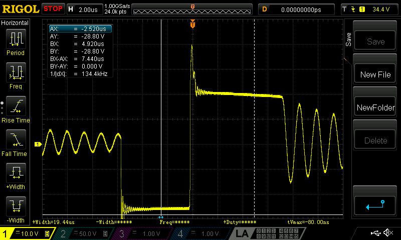

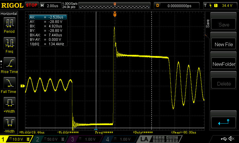

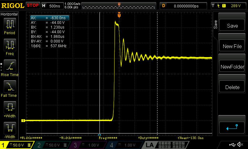

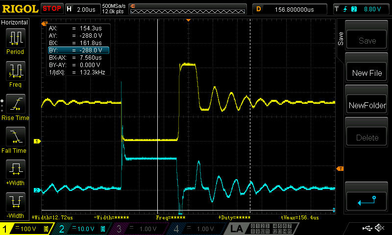

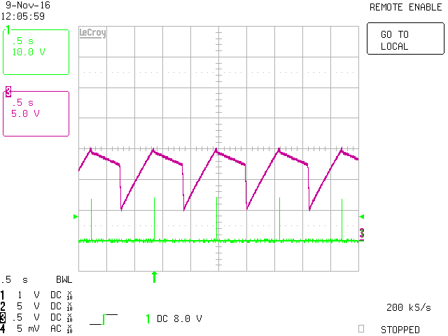

  • now looking at a new error code having use the force turns in the spread sheet - it was coming up 35:4 instead of 32:4 when i told it a turns ration of 8:1 changing Rb from 41K or 44K to 48K. this got a an error code i had not seen yet: output over voltage... it was going to over 20V and coming back down.  tacked on a 1000uF cap and a 5K resistor before the output inductor...
    after putting in a 150V transorb clamp the waveforms are looking good but the reflected voltage is high.  the chip is reporting over voltage now due to the 22V reflected on a 12V output from a 1:1 sec:bias ratio.  might be able to "bring it down" with Rb but i suspect it is the leakage and am not sure how repeatable that would be ... (but i do not really care about absolute accuracy anyhow, anything consistent between 12 and 15V would be fine)
    all have the FET gate in blue... the drain voltage is clamped at 150V but perhalps i should add another 75V transorb:
    the current looks like it is ramping up to 1.5A ( 0.5V/0.4 ohm)
    the bias winding is "reading" 150V while a meter read 123V and the output as 22V but is only reaching 6 or 8V
    Definitely a step in the right direction

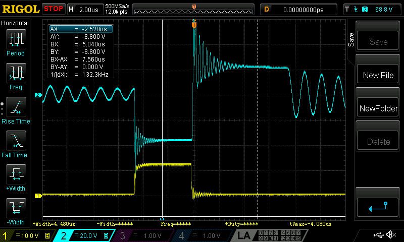

  • Dan,
    I think that your transformer is cause of all the issues.
    As I said previously, 100 uH leakage is just way too much. Even 50 uH is too high.
    The last plot above shows what's most likely going wrong. When the FET turns off, there is so much leakage energy due to the extreme leakage inductance, that the drain rings up to the 150-V transorb level and gets clamped. And it stays clamped for almost 2 us. This leakage clamp level also appears at the aux winding and the VSENSE pin.
    At ~1.7 us after the falling edge on DRV, the VSENSE pin is sampled, and the measurement is used as a proxy for the secondary output voltage. So the clamp level is being sensed as Vout rather than the real Vout. Once the leakage ringing swings back, the transorb stops clamping, and since so much energy has been taken out of the leakage it then rings to a much lower level and is no longer clamped.
    Then right at the end, you can see the aux waveform start to dip - this is the point where the secondary current has decayed to zero and the transformer is demagnetised, so the level just before the demagnetisation "knee" is the real reflected output voltage that should be sampled.
    Without the transorb, the leakage is probably clamped at a much higher level, which is being sampled erroneously as reflected Vout, and hence appears to be an output OV condition.
    You need a transformer which far less leakage inductance, the leakage ringing has to have subsided in the first 1-1.5 us.
    Can you share the zipped xlsm file and the transformer spec/construction?

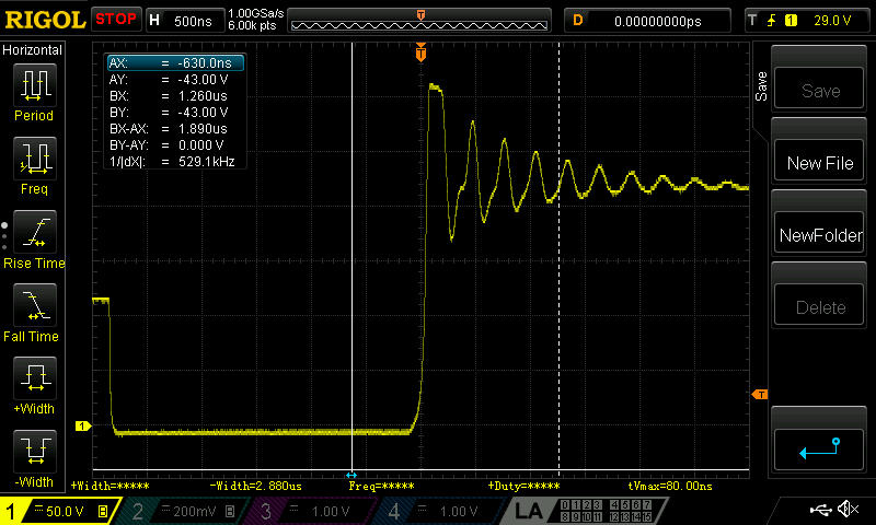

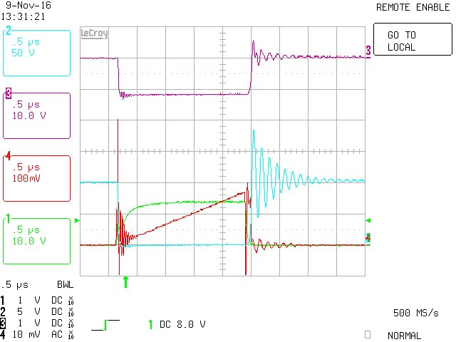

  • ok still not starting... using a different transformer with lower leakage (that we had in house) and higher output voltage to make the ratios right for the 12V VDD rail.  Using a new scope probe with out the foolish clip leads and have much cleaner wave forms showing the ringing down, but not gone at 1.7uS.

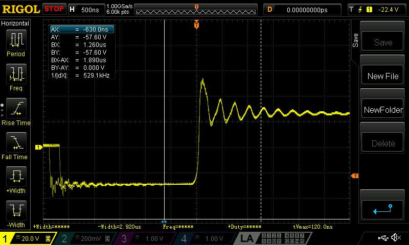

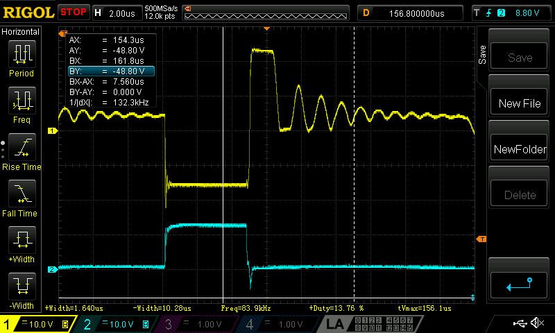

    well crap... things are looking better... a lot of the hash was the "probe" leads, but i knew it was:
  • Dan
    Can you tell us the details of the latest transformer being used (inductance, turns ratios, Rcs value)? With so many previous posts, it’s not clear what you are testing with right now.
    For sure it looks a lot better. What output load setting are you using? Does the power stage only fall over for VDD UV at no or light load? Can you get it to regulate or stay running with more load added? Once it starts up, how long does it stay running? Can you capture the VDD waveform from startup to the point of UV?
    I assume the upper waveform is the aux winding or the anode of the aux diode, and the second one is the FET drain, can you confirm?
    Assuming the second is FET drain, it looks like Vin ~125 V, and the reflected output voltage ~100 V. The primary clamp is ~200 V.
    Assuming the first one is aux winding, it looks like the output voltage reflected to aux is very high, ~24 V. How is this being stepped down to the required 12-16 V level needed by the IC?
    While there is still ringing on the aux waveform, it will be filtered at the VSENSE pin, the ringing might cause regulation issues, but it should not cause things to fall over in the way you are seeing.
    If it's shutting down for VDD UV, then it may mean that:
    - there is some external load on VDD
    - the aux winding feed has an open somewhere - check the aux diode and series R
    - the VDD cap is too small (should only be a problem at low Fsw, i.e. light load) – are you only using ceramics? Their capacitance value rolls off a lot with DC-bias, so there could be a lot less C value.
    - the series R with the aux diode is too large (or has gone high-ish impedance)
    For debug, you could try connecting an external dc source to VDD through a blocking diode. Set this external Vbias to say 10 V or so, high enough to stay above the UV level but not high enough to get over the start threshold. Set the current limit low, maybe 10-20 mA max. Connect the external Vbias first, with the high voltage input turned off. Then apply the high voltage input, HV will charge VDD from the starting external Vbias level to the start threshold, then the IC switching and bias power will pull VDD down, but it should get caught by the external Vbias and keep the IC running. You can they see how much bias power is being drawn from the external Vbias to see if there is an issue or some other unexpected loading. You can also observe other waveforms and see if things regulate properly and if the issue is only being caused by the aux bias/VDD.
    Bernard

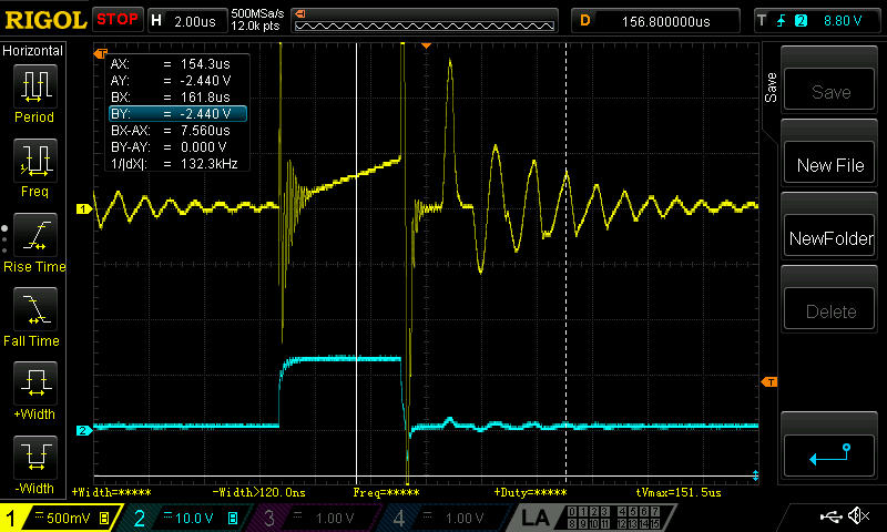

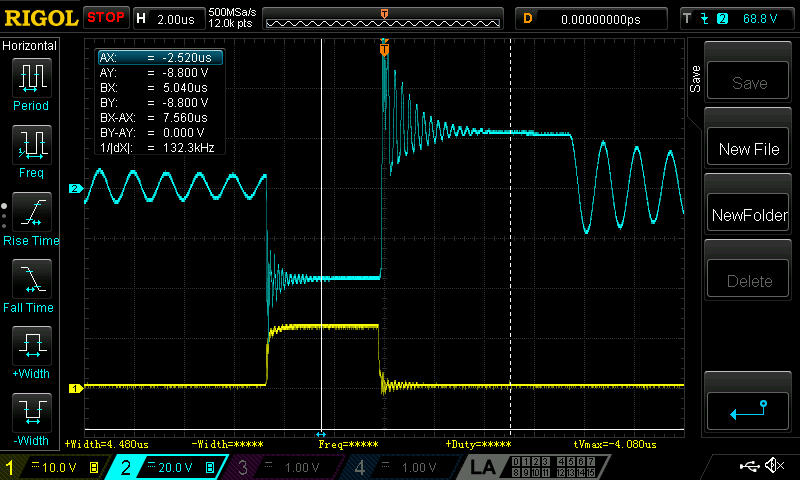

  • tacking in a regulator now. the transformer on there now is the one that is 1.5:1 so i would expect only 18V and not the 24V if it was running ... however, it is not staying on, the output is not getting to 12V as i recall, VDD is not getting to 15V and it is not reporting any error but VDDuv.
  • OK ... running with a Vdd regulator ... must have been rushed: Rb was low .. re-entered the transformer and stuff and increased Rb but the 34.5K suggested caused a fault since the 33.2K I put in did.   running with 30.1K for Rb
    you were right about the bias series resister: it was freshly put in but basically open - likely due to my not checking the iron before i started: production likes them set 800 for ROHS ... Always gives me trouble since that tends to boil off both flux and solder before it takes
    reports CS pin fault when "starting" into a 1.2A load.  temperature on both the unheatsunk power switch and the transformer are around 38F.
    here are the new bias, drain and spreadsheet files
    EDIT: 40V spike on the bias winding looks a bit ugly, guess i might be needing that filter cap on Vsense  2727.105B057.zip
  • Dan,
    It looks like good progress, the waveforms are looking better.
    So to be clear, when you soldered the resistor in series with the aux diode, were you able to get the power supply to start up and run? Or did you still need the external bias supply?
    Is the remaining issue the CS fault when starting into 1.2-A load? The starting load should be irrelevant for the CS fault, since open CS is detected at startup before any PWM drive signals are generated, and shorted CS fault is detected based on only the frist 3 PWM cycles.
    The CS fault could be a red herring and could be a consequential occurence after a previous fault has occurred.
    I also thin kthat 1.5:1 aux:sec ratio is too high and will drive VDD up to UV fault level - unless to have put into a series regulator to drop it down?
    Can you summarise current behaviour/performance and list any remaining issues to be addressed?
