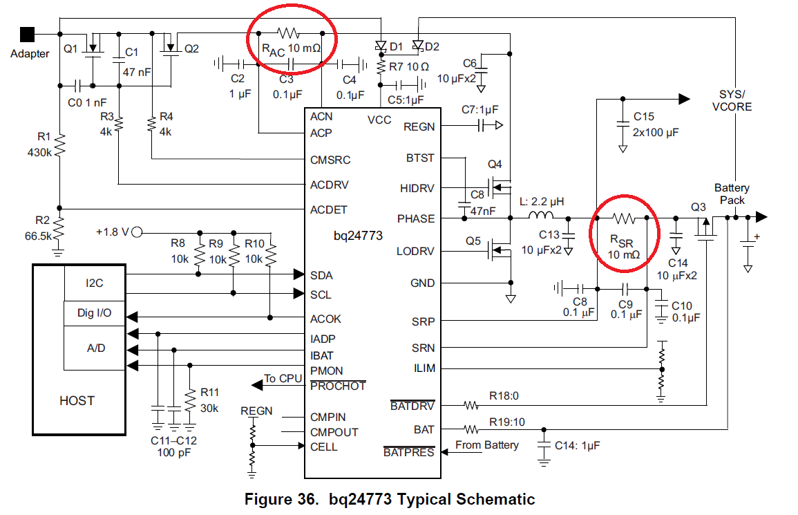

In order to decrease impedance, do we decrease RAC and RSR resistor value from 10m ohm to 5m ohm? Thank you.

Hi Patrick,
Which impedance are you trying to decrease, and why? Lowering the resistance of the sense resistors does decrease the resistance (real part of the impedance, not reactive part) of the sense resistor. Just keep in mind that it will increase your charge current.
