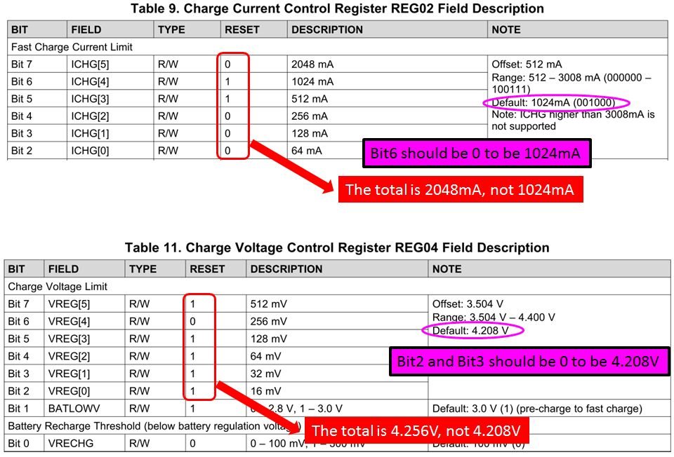

I'm referring the default value of ICHG and VREG registers in datasheet, but I think the RESET value in these table has typo. Please see attached and give your comment.

Hey Sonoki,
Thank you for spotting this. The default values listed are correct, but the RESET values are not.
REG02[7:2] RESET bits should read 001000
REG08[7:2] RESET bits should read 101100
We will change this on the next update of the datasheet.
