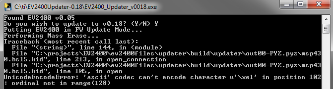

I've just bought an EV2400 to work with a BQ27510-G3. After setting up the I2C connection and installing bqStudio I was able to communicate wit the gas gauge, so the hardware seems to be ok.
The firmware version of the EV2400 was 0.05 originally, so I downloaded the EV2400_Updater_v0018.exe from the official webpage and tried to upgrade. My computer is Win7 x64 SP1.
I got this:

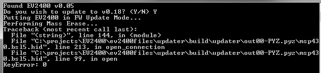

After changing my unicode file settings to English US (from Hungarian) as it was suggested here, I got this:
I tried to run the updater normally and with the -s option too. I tried another laptop, (with default settings and with US english settings), without success (inspired by this post).
Please help me: what else should I try? What other Windows settings may affect the updater?

    Yes, it is. The only difference is that the updater always opens up a separate window. So this is my result with -s:
    And without -s:
    (I had to use a screen video recoder program, because the program quits so quickly that I could not press PrintScreen fast enough...)
    Attila
  • I finally solved the problem: I get an old computer (there was some windows XP on it) and made a fresh Windows 7 x86 SP1 ENG install on the "new" machine with the default language settings: US english. (I did nor even registered the Windows yet.)
    After copying a "missing" msvcr100.dll to the c:\windows\system32 folder, the upgrade went succesfully.
    I know that this was a brute force solution, so if someone knows how to "tune" an existing operation system, please share the information.
  • HI Attila,
    Thanks for sharing this. I drew our tools/firmware team's attention to this and they confirmed that this version of the updater does have problems with non-English Windows due to a python limitation. A new updater for the v0.18 will be updated online soon, but glad you got a work around to your issue.
