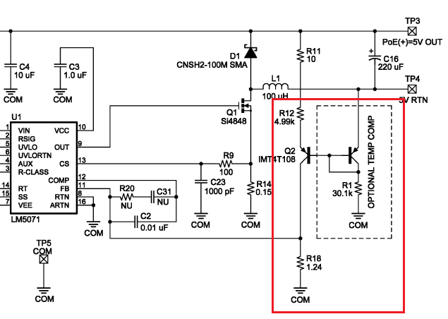

We have been design POE module by using LM5071. And we would like to design a compact non-isolation 12-V POE module by using LM5071.
Is there any guideline to modify the feedback loop (Q2, R1, R12, R18 and optional Transistor for temperature-compensation shown on page-17 of LM5071's data sheet)  for 12V output? Thanks~
