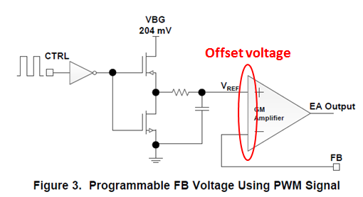

Hi Team,
Our customer worry about VFB of linearity at low Duty.
Because, they worry whether the offset of internal GM Amplifier have a bad influence to VFB at low duty.

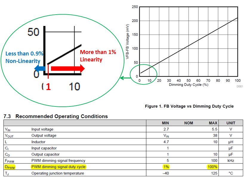

I understand that TPS61169 has VFB of linearity at PWM dimming signal duty cycle is from 1% to 100%.
Is my understanding correct?
If no, could you please let us know the range of PWM dimming signal duty cycle that TPS61169 can maintain the VFB of linearity?

  • Hello Kanemaru,
    Yes, your understanding is correct.
    The TPS61169 VFB Linearity is specified from 1% to 100% PWM Duty Cycle.
    Let me know if you need additional information regarding the customers concern.

    I would like to know VREF accuracy at Duty = 10% to 99%.
    Could you please let us know it if “VREF accuracy at Duty=10% to 99%” and “VREF accuracy at Duty=100%” are different?
    Kanemaru
  • Hello Kanemaru-san,
    There is not any difference between VREF accuracy 10% to 99% and 10% to 100%.
    Randy
