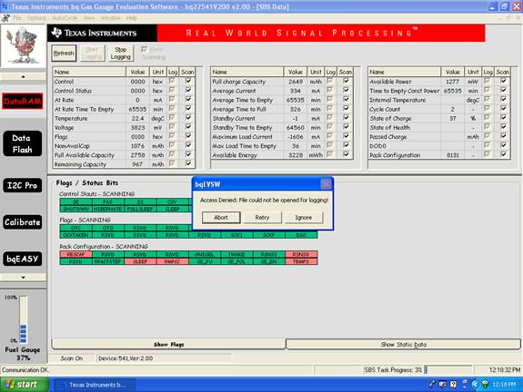

I left my gas gauge evaluation software logging but it stops randomly, sometimes turning on again after a few hours.  The duration of the data logging seems random.  I get this error message:
Solution:
My log file was being saved to a network drive over WiFi.  Changing to save the log file on my local hard disk drive solved the intermittent problems.
