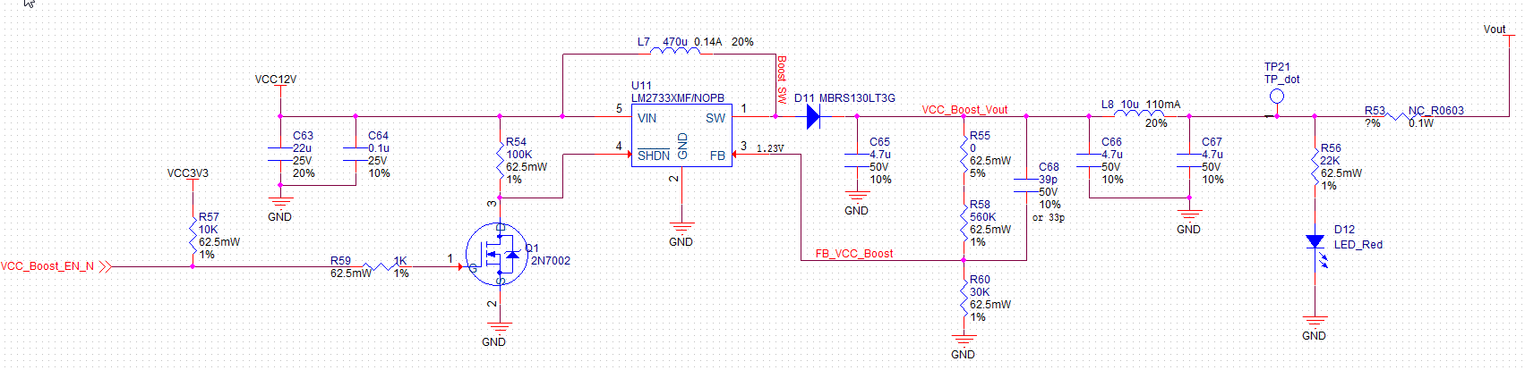

We are using LM2733X to boost VCC12V to Vout(24V), output current load is small, like 10~20mA.
When LM2733 is enabled, VCC12V has momentary drop down, which is not we want to see. As VCC12V is generated from upstream LDO TPS7A4901, whose I_out capacity is max. 150mA. So I think this drop down problem may be caused by inrush current when Vout is ramping.
We do not want to change TPS7A4901. Is there any way to add soft-start to LM2733 circuit, so VCC12V will hold on? SCH and test wave below.

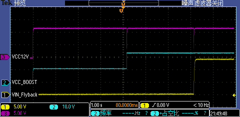

Channel 2 and Channel 3 is VCC12V and Vout(24V) respectively.
    You may be able to increase the 39pF feed-forward cap to substantially improve the matter. Start with a value like 0.1uF as a staring point. use only enough C to get the desired amount of improvement. The problem with this approach is  it may work on the first enable but if you disable and re-enable quickly it may not properly perform. This capacitor can impact transient response but probably is not a factor in your loading condition.
    A second method is to add a PNP and RC network as follows: this allows large freedom in adjustment and a good candidate for a simulator. I just reused the feedback divider resistor values as a starting point. The values will need to be optimized. The diode resets the cap during shutdown.
     2733-Soft-Start.docx

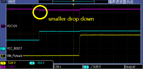

  • Hi Alan,

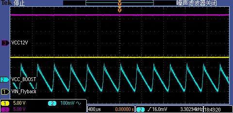

    At first, I tried increase C68 to 10nF, the drop down of VCC12V indeed decreased(as picture 1 below). Unfortunately the voltage ripple of 24V output became abnormally larger(as picture 2 below), which is not wanted.
    I changed this feed forward cap value for several times, here is the dilemma:
    (1)If the cap value is too small, VCC12V will have large drop down; Vout ripple is normal, very small, like less than 20mVpp.
    (2)If the cap value is too large(about > 5.6nF), Vout will be "dirty" with much larger ripple, looks like circuit become unstable. I am not sure how this cap will influence  loop response of boost circuit, but from the test phenomenons, I think lager cap value leads to bad dynamic performance, which means bad ripples on Vout.
    So, the soft-start is not easy to add for LM2733. Could you please give some insight? Thanks, and happy weekend!
    Pic 1: 10nF C68 reduced Vin drop down.
    Pic 2: Chanel2 ripple, measured by AC coupling .

  • Hi Alan,
    Today I tried use adding 56K resistor in series with the feed forward cap 10nf. The result is unchanged with single 10nF condition.
