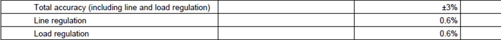

- Vout calculation accuracy:
* 8.5 Electrical characteristics
Is the total accuracy 3% valid for fixed output voltage DC-DC, or is it also valid for adjustable DC-DC?
For ajustable DC-DC the output votage is calculated with the formula Vout = (R3+R4)/R4*VFB.
So in my opinion, Vout accuracy depends on the accuracies of:
- the TPS61029: specified value 3%??
- VFB: specified value 2%
- the maximum leakage current of the VFB input
- the resistors R3 and R4: depends on resistors choice
How do we calculate Vout total accuracy for the TPS61029?
- Do we use the formula Vout = (R3+R4)/R4*VFB taking in account the accuracies of VFB, R3, R4 and VFB leakage current?
- What is the maximum leakage current of the VFB input? (I couldn’t find it on the D/s)
- Do we also take in account the specified total accuracy +-3%?
