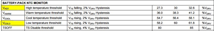

    After taking a look at the part again, the bq24266 and that family of parts (bq2426x) have a battery detection feature, so the capacitor does not play a role in this issue.
    What is most likely happening is a TS fault for your device (i.e. the TS voltage is too high or too low, triggering a TS fault). This fault also shows as a /CHG low status, meaning the LED will turn on.
    That is why the LED is on in our EVM. The EVM has a potentiometer to simulate TS temperature faults, and if the resistance is too high or too low, you will fall into one of the TS fault conditions.
    Bottom line: Leave the capacitor in. You do not have to pull TS high. Make sure TS voltage falls within this range:
    Joel H

    Thanks, I understand you meanings . I will try to adjust the resistors ( let the Ts voltage falls between Vhot and Vcold).
    But I have a question, when we pull Ts to GND directly , Ts will also be out of the range , why is the /CHG is
    high impedance status and doesn't indicate Ts fault?

    When you pull TS to GND directly, the /CHG should be LOW because V_TS is recognized as T_hot to the charger.
    How are you pulling TS to ground? And is this on our EVM?
