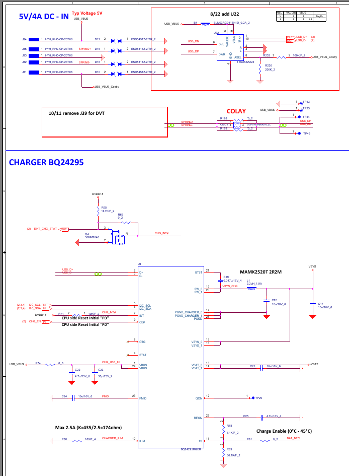

1) And the product used an AC adapter for battery charging.
1-1) The USB D+/D- pins of AC adapter are shorted and connected to GROUND.

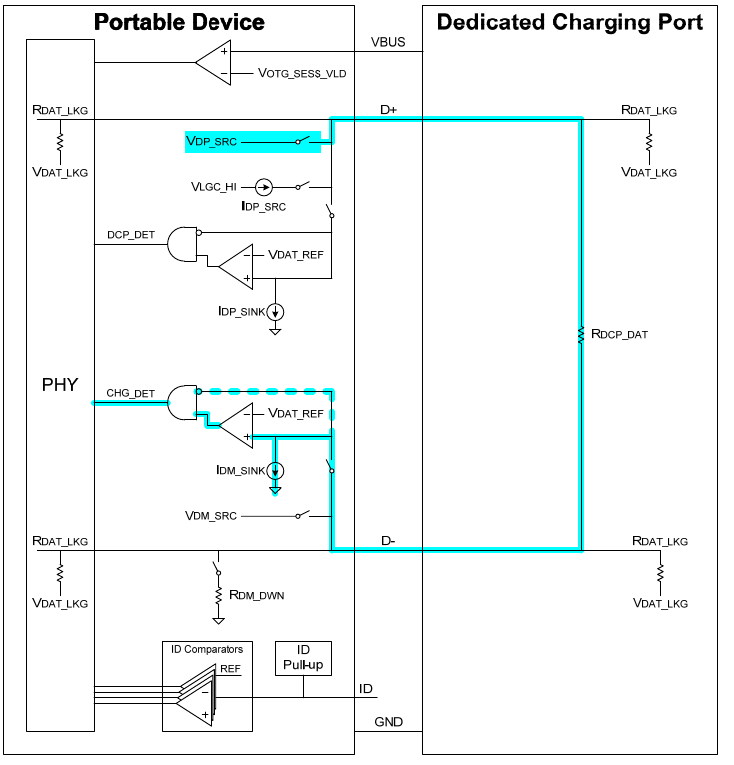

3) About the BQ24295 Non-Standard Adapter Detection, please refer to the picture below.
4) About the power circuit of BQ24295, please refer to the picture below.

  • Hey Hank,
    Q-1) If I understood your setup correctly, because you have the D+ and D- pins tied together AND tied to ground, the bq24295 will do Primery Detection.
    Q-2) Because the charger will run Primary Detection on your adapter is stated above, it will not look like a Non-Standard adapter to the charger. In fact, it will most likely look like a SDP to the 24295 based on the configuration you described.

    1) In the Battery Charging Specification 1.2 (December 7, 2010),
    1-1) In the Chapter 3.2.3.1, it describes the DCD (Data Contact Detect) as follows:
    >>  A PD is not required to implement DCD.
    1-2) In the Chapter 3.2.4, it describes the Primary Detection as follows:
    >> A PD is required to implement Primary Detection.
    1-3)  a DCP (Dedicated Charging Port) is required to short D+ to D- through a resistance of RDCP_DAT,
    and the PD will detect a voltage on D- the is close to VDP_SRC.
        About the details, please refer to the picture below.
    1-3-1) The RDCP_DAT is maximum 200 ohm in BC1.2 specification.

    Q-3) Are the following detection procedures of this AC adapter with BQ24295 correct?
    3-1) The detection of DCD with BQ24295 failed because the USB D+/D- pins of this AC adapter are shorted.
    3-2) And then, BQ24295 did the Primary Detection (Not detection of Non-Standard Adapter)
    3-2-1) The Primary Detection of DCP failed because this AC adapter does not have the RDCP_DAT resistor.
    3-2-2) So, the BQ24295 detected this AC adapter as USB host (SDP).
    Thank you.
  • Hey Hank,
    So this is the procedure that will happen on our charger because the D+ and D- are Shorted AND Grounded.
    1) The adapter will PASS detection of DCD because the voltage @ D+ will be below a certain threshold.
    2) From DCD detection, it will perform Primary Detection (PD). Because the D- voltage is also below a certain threshold, our charger will identify your adapter as a SDP.
    So it failed DCP detection because you have D- connected to ground, not because they are shorted.
    Joel H
