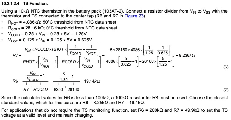

Hi Sir,
May I know about BQ24075T TS Pin function formula based on what condition?
Looks divided resistor with internal comparator voltage.  but formula looks not.
  • Hello Kuo Nowal
    Conditions for TS Pin function formula.
    Vin = 5V
    V-cold is 25% of Vin = 0.25 X 5V
    V-hot is 12.5% of Vin = 0.125 X 5V
    Max temp 50C
    Min temp 0C
    NTC used is Semitec 103AT-2
    The R-cold, min temp of 0C should use 27.28k from data sheet vs 28.16k.
    The R-hot. max temp of 50C should use 4.160k from data sheet vs 4.086k.
