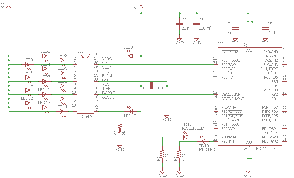

I am a first-time poster who working on an LED lighting system for my RC truck as an exercise electronics and microcontrollers (I studied EE in college but am now working in systems engineering). Following tutorials seen here () and here (), I chose the TLC5940 driven by a PIC16887 using SPI to send greyscale data. The TLC5940 is driven from the PIC's internal 1 Mhz clock, which uses an interrupt to trigger BLANK every 4096 clock cycles. My first main() function turns each LED on in sequence then turns each off, in a continual loop. So far this implementation is working, except for one significant glitch.
I am having trouble with LED 15: it does not turn on/off when my program activates it, but instead seems to be "linked" to LED1 or LED14 depending on which way the sequence goes. If I increment the channelCounter starting at 0, LED1 and LED15 turn on/off together. If I decrement the channelCounter starting at 15, LED14 comes on when LED15 is turned off and vice versa. It's almost as if LED15's data in my gsData array is wrapping around between position 0 and 15.
I have used MPLAB's debugger to step through my code several times, and confirmed that the greyscale value bit-packing is setting the correctly. I also confirmed with an oscilloscope that BLANK is being triggered every 4.1 ms (a hair over 4.096 ms). The scope is analog so I cannot do much troubleshooting on the serial signal but all other signals appear to be functioning as intended. The issue is easily repeated with no variance so I don't believe wiring or breadboard problems are the culprit. All other LEDs turn on and off as expected.
I suspect perhaps the SPI implementation or timing may be the culprit, but have hit the proverbial wall in my analysis. Has anyone else experienced this issue before? If so, what was the cause/solution in your application? Could my bitpacking or SPI implementation still be off-kilter? If you have any suggestions or thoughts I am very much interested in hearing them. I have attached my C code as well as a schematic of the system to this post.

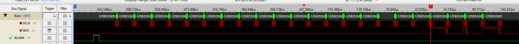

  • Over the Christmas holiday, I got myself a Zeroplus logic analyzer and decided to probe the circuit out. I am finding that the information being sent by the PIC to the TLC5940 is indeed correct, and the SPI transmission is being completed within about 750 us, while BLANK is being triggered every 4.14 ms. The capture posted below shows that the data transmission finishing well in advance before the next BLANK (green pulse), and that LED15 has no data written to it. This capture was triggered shortly after LED1 and LED2 were set to 250, but LED15 was also turned on as well.
    I'm still at a loss as to what is causing these two LEDs to turn on with each other. If anyone has any thoughts or suggestions, I'd greatly appreciate hearing them.
    TJ
