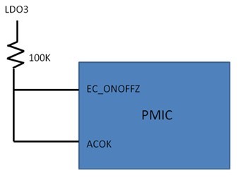

TPS650832 alternative way to exit emergency shutdown trigger by long press PWRBTNIN
Other Parts Discussed in Thread: TPS650832
TPS650832 would enter emergency shutdown by long pressing PWRBTNIN.  Customer would like to have the chip exit emergency shutdown automatically when the user release the PWRBTNIN (from long pressing it to enter emergency shutdown.)
Their proposal is as below.  Since EC_ONOFFZ will be driven low when PWRBTININ is triggered low, when PWRBTININ is released we expect ACOK will be driven high as well.  ACOK rising edge is an event to exit emergency shutdown.  Do you think this is workable?
