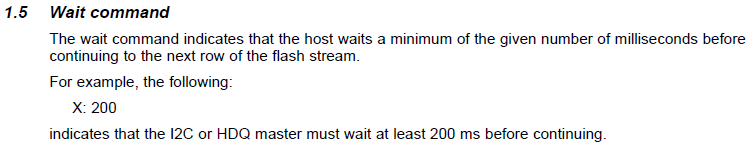

He used DFFS file that is output by bqstudio and write the data to each bq27520-G4s however sometimes write failure was occured.
I heard the failure is about 1/20 probability.
Is it possible case for bq27520-G4?
As a trial, he increased the wait time (X: value) in wait command in DFFS, probability of write failure decreased dramatically.
http://www.tij.co.jp/jp/lit/an/slua541a/slua541a.pdf
How much wait time should he increase to prevent the write failure?
Is there any other workaround?
Could you set appropriate wait time if I send my customer's DFF file?
Yaita / Japan disty
  • hi Yaita,
    When you say failed, how are you determining this failure? waht parameters are you observing to say the programming failed.  What value did the customer increase the wait time to? Was the flashstream which the customer is using extracted from the gauge using bqstudio.  Indeed we have seen cases were insufficient wait time between writes has caused failures and 200ms has been  a good number that worked in most cases. If 200 ms doesn't work in your case, then there will be a need to increase that time to say 300ms.

    I heard write failure means the device is still in ROM mode after programming DFFS file.
    He uses DFFS file that is extracted from the bqstudio and as a trial he added 10ms wait time every line in DFFS file write failure doesn't occur after that.
    I believe the cause comes from the capacitance of I2C lines as you said in the following, so I will talk to my customer in terms of it .
