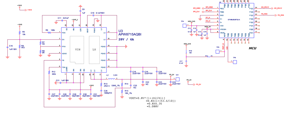

Hi Sir,
Could you kindly help us to provide TPS65286EVM schematic .DSN file?
We can propose to my customer replace DC/DC and two Load switch.
Application Type-C PD Ducking (none-DP)

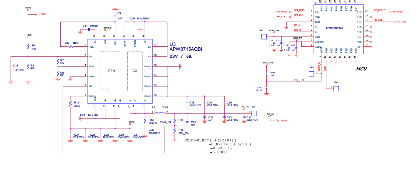

Hi Sir,
