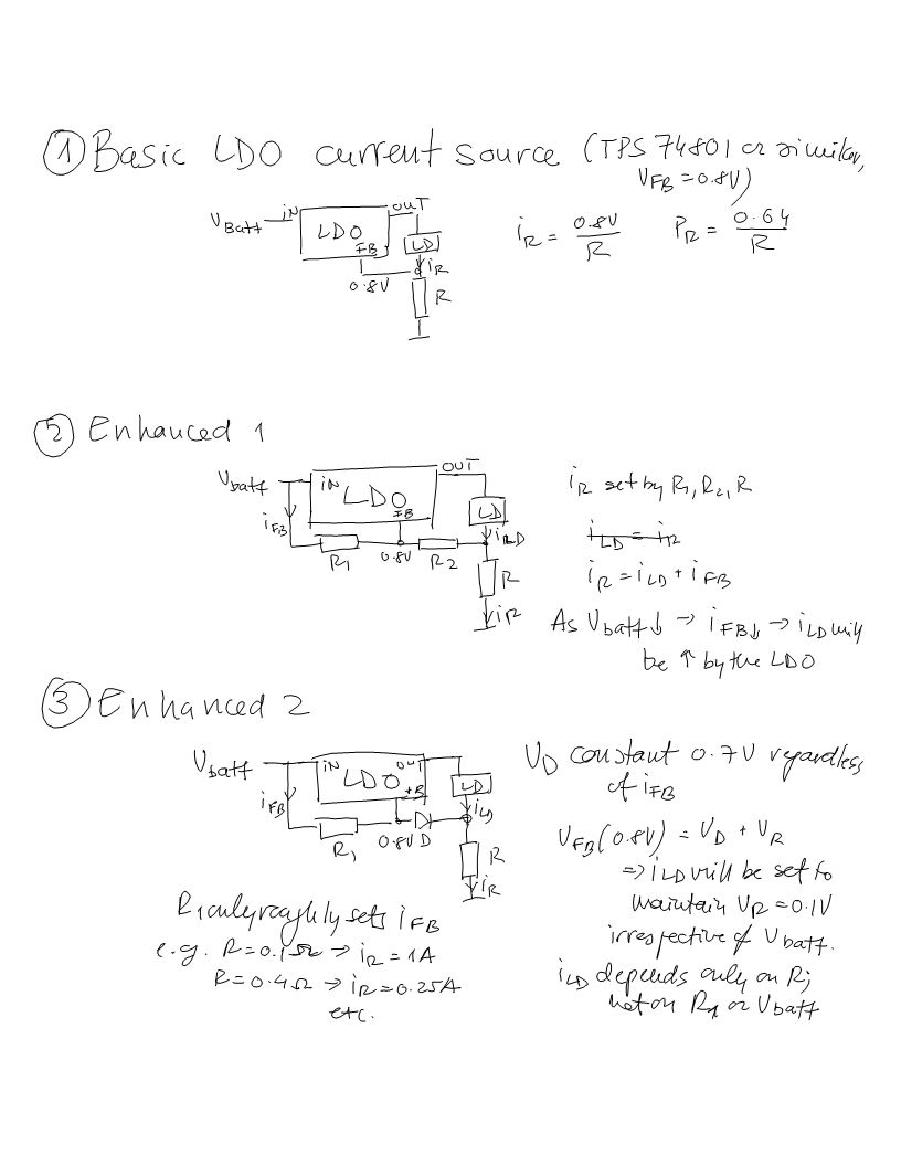

  • Hello Shenle,
    Here is an untested solution using the TPS74801. I included an alternative method for changing the current from 0.8A to 1.3A.
    It should work with VIN = 4V to 5.5V.
    Ron M.

  • Hello Shenle,
    Please send me a drawing of what you mean.  Typically when we want to use an LDO regulator as a current source we use one of two circuits shown in the attached diagram.  In both circuits the current is set by the "current sense" resistor immediately beneath the load.  The smaller the current sense resistor the better the efficiency.  Regarding the top circuit, efficiency can be improved by using an LDO with a lower feeback reference voltage - newer LDOs have references as low as.6V.   The lower circuit affords the best efficiency because the current sense resistor can be somewhat arbitrarily small - at the cost of requiring the pull-up resistor divider connected to another regulated voltage (in this case the Vin voltage).
    Bill

  • Thank you for your suggestions!
    Ron, that's an interesting design. Well worth a try.
    Bill, I'll give that last circuit a try. A couple extra resistors for the sake of saving a watt is well worth it.
    Thanks again!
  • The last design has the following problem: if Vin is not stabilized, as the battery life runs out Vin will drop, thus current through the divider will drop thus the LDO will try to compensate by increasing the output current. This is undesired and even dangerous.
    See my solution for this problem in the third panel attached. Basically I am stabilizing part of the voltage applied to FB, and letting the only variable be the voltage drop on R, dependent on the load current.
