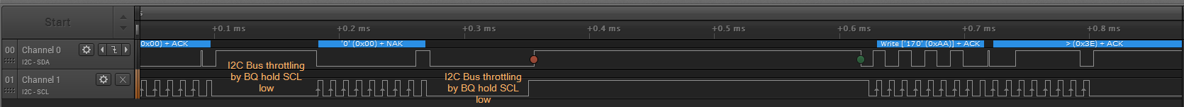

- After the above testing procedure the BQ does not respond on the I2C bus anymore
- no action on SDA lane (neither ACK nor data transfer): SDA lane stays high due to pull-up whenever BQ has SDA control
- no attempt to hold SCL lane low to throttle bus speed
- non responding BQ may appear at any stage
- within transfering a read byte from BQ to MCU
- after a successful completion of a read/write bus transfer
- while writing the register address to the BQ
- BQ deactivates the charge & discharge FETs
- After a certain time (not further evaluated at this point) the BQ continous to respond normally to any I2C requests

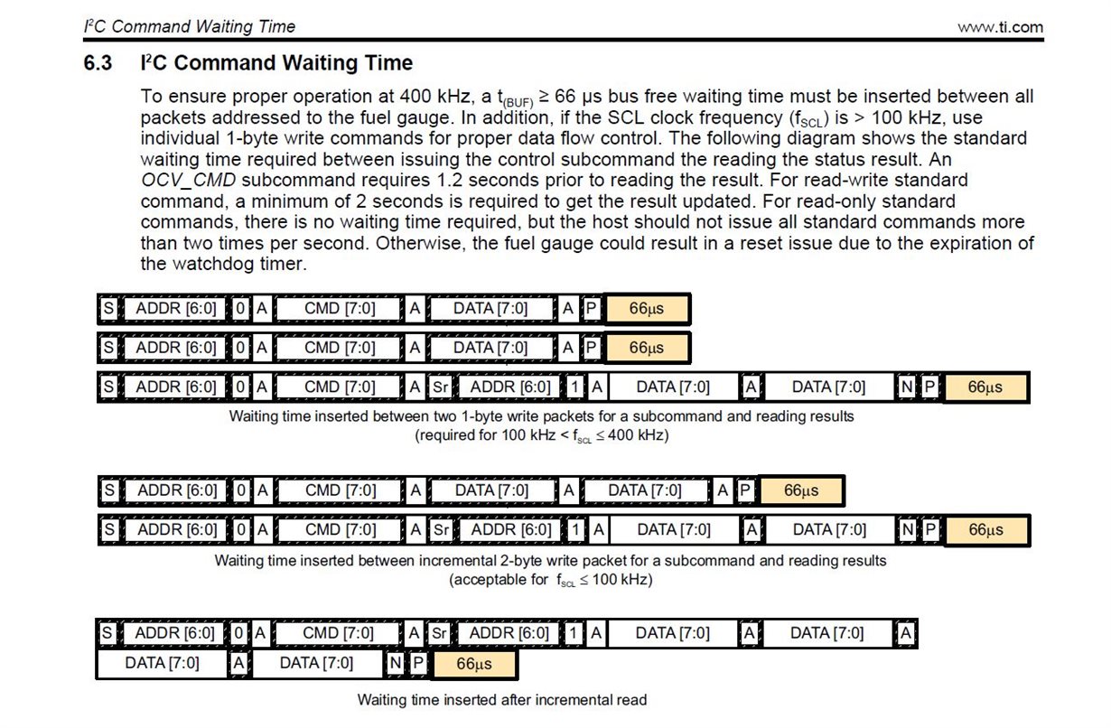

- Increasing the delay (TestDly) between 2 consecutive I2C register reads reduces the probability of this error
- When I run the Test with the Battery Management Studio & the EV2300 adapter I could not reproduce the error (but I noticed a delay of ~14ms between 2 reads)
- However I have not found any hint in any datasheet about any delay requirements except the "bus free time between stop and start" of 1.3 us (which we do meet of course)

- I have captured the activity on the I2C bus during the error:
- I personally have the following theory:
