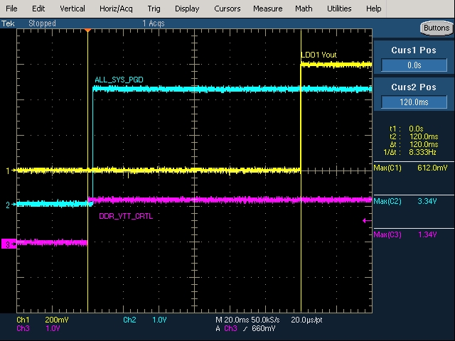

We specifify the enable timing from LDO1 enable to LDO1 output as 35uS MAX, ut customer got longer timing as below. Can you explain why it takes longer than expected?

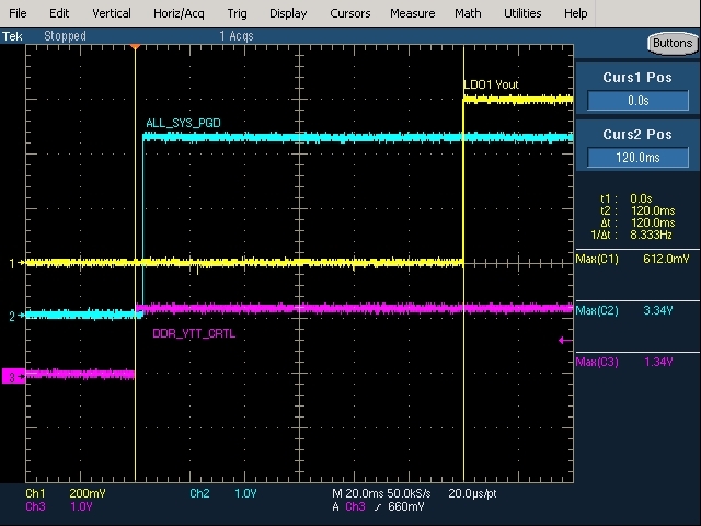

Hi Antony,
According to bit 0 in register 0xEA, LDO1 will follow the delayed power-good signal, SYS_PWROK, which should have about a 100ms delay from ALL_SYS_PWRGD.
This delay is per specification and the PMIC has been qualified with this configuration, setting register 0xEA to 0xFF should affect this delay but would result in an unqualified configuration.
