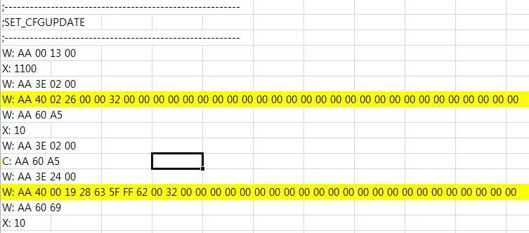

Hi Team,
BQ27621_RS_Battery.xls
With using EVM, set up the battery parameter as attached Excel file.
then I export dolden image and use this file on sample board, it happened data error from 30 row(C: AA 60 E5)
Q1) Can you share the reference code?
Q2) do we have to input delay time(200ms)? data writing time is so long.
Q3) Can you check the source code as below?

uint8_t BlockConfigArry[14][BATT_I2C_WRITE_MAX_SIZE]={
	{0x02,0x26,0x00,0x00,0x32,0x00,0x00,0x00,0x00,0x00,0x00,0x00,0x00,0x00,0x00,0x00,0x00,0x00,0x00,0x00,0x00,0x00,0x00,0x00,0x00,0x00,0x00,0x00,0x00,0x00,0x00,0x00},
	{0x00,0x19,0x28,0x63,0x5F,0xFF,0x62,0x00,0x32,0x00,0x00,0x00,0x00,0x00,0x00,0x00,0x00,0x00,0x00,0x00,0x00,0x00,0x00,0x00,0x00,0x00,0x00,0x00,0x00,0x00,0x00,0x00},
	{0x10,0xFE,0xFD,0xFF,0x38,0x00,0x00,0x00,0x00,0x00,0x00,0x00,0x00,0x00,0x00,0x00,0x00,0x00,0x00,0x00,0x00,0x00,0x00,0x00,0x00,0x00,0x00,0x00,0x00,0x00,0x00,0x00},
	{0x0A,0x0F,0x02,0x05,0x32,0x00,0x00,0x00,0x00,0x00,0x00,0x00,0x00,0x00,0x00,0x00,0x00,0x00,0x00,0x00,0x00,0x00,0x00,0x00,0x00,0x00,0x00,0x00,0x00,0x00,0x00,0x00},
	{0xB4,0xD8,0x0C,0x02,0x00,0xC8,0x04,0x00,0x09,0x00,0x00,0x00,0x00,0x00,0x00,0x00,0x00,0x00,0x00,0x00,0x00,0x00,0x00,0x00,0x00,0x00,0x00,0x00,0x00,0x00,0x00,0x00},
	{0x14,0x00,0x03,0x08,0x98,0x00,0x00,0x00,0x00,0x00,0x00,0x00,0x00,0x00,0x00,0x00,0x00,0x00,0x00,0x00,0x00,0x00,0x00,0x00,0x00,0x00,0x00,0x00,0x00,0x00,0x00,0x00},
	{0x02,0xBC,0x01,0x2C,0x00,0x1E,0x00,0xC8,0xC8,0x14,0x08,0x00,0x3C,0x0E,0x10,0x00,0x0A,0x46,0x14,0x05,0x0F,0x03,0xE8,0x00,0x64,0x46,0x50,0x0A,0x19,0x28,0x01,0xF4},
	{0x00,0x00,0x00,0x00,0x00,0x00,0x00,0x00,0x43,0x80,0x04,0x01,0x14,0x00,0x00,0x0B,0xB8,0x01,0x2C,0x0A,0x01,0x0A,0x00,0x00,0x00,0xC8,0x00,0x64,0x02,0x5A,0x20,0x64},
	{0x0F,0x02,0x00,0x05,0x04,0xB0,0x0F,0x00,0x00,0x00,0x00,0x00,0x00,0x00,0x00,0x00,0x00,0x00,0x00,0x00,0x00,0x00,0x00,0x00,0x00,0x00,0x00,0x00,0x00,0x00,0x00,0x00},
	{0x00,0xA7,0x00,0x64,0x00,0xFA,0x00,0x3C,0x3C,0x01,0xB3,0xB3,0x01,0x90,0x00,0x00,0x00,0x00,0x00,0x00,0x00,0x00,0x00,0x00,0x00,0x00,0x00,0x00,0x00,0x00,0x00,0x00},
	{0x43,0x33,0x00,0x03,0x39,0x0C,0x4E,0x09,0x79,0x0C,0x80,0x00,0xC8,0x00,0x32,0x00,0x14,0x03,0xE8,0x01,0x00,0xC8,0x10,0x04,0x00,0x0A,0x10,0xDD,0xFF,0xCE,0xFF,0xCE},
	{0x00,0x01,0x02,0xBC,0x12,0x02,0x00,0x00,0x00,0x00,0x00,0x00,0x00,0x00,0x00,0x00,0x00,0x00,0x00,0x00,0x00,0x00,0x00,0x00,0x00,0x00,0x00,0x00,0x00,0x00,0x00,0x00},
	{0x00,0x1D,0x00,0x1E,0x00,0x22,0x00,0x2E,0x00,0x26,0x00,0x20,0x00,0x25,0x00,0x1F,0x00,0x20,0x00,0x23,0x00,0x27,0x00,0x27,0x00,0x3D,0x00,0x73,0x00,0xC8,0x00,0x00},
	{0x80,0x00,0x80,0x00,0x00,0x00,0x00,0x00,0x00,0x00,0x00,0x00,0x00,0x00,0x00,0x00,0x00,0x00,0x00,0x00,0x00,0x00,0x00,0x00,0x00,0x00,0x00,0x00,0x00,0x00,0x00,0x00},

void gauge_full_sequence(void)
	uint8_t CheckSum_Result=0;
	uint8_t Return_Val=0;
	uint16_t config_lookCnt=0;
	BlockCfg_Seq=0;
	// 	-------------------------------------------------------------------------------------------->>>>>>>>> Verify Existing Firmware Version
	Batt_i2c_Buff.write[0]=(uint8_t)(CONTROL_DEVICE_TYPE);
	Batt_i2c_Buff.write[1]=(uint8_t)(CONTROL_DEVICE_TYPE >> 8);
	batt_i2c_write(REG_CTRL,Batt_i2c_Buff.write,2);
	Batt_i2c_Buff.readSwap[0].u16_data = 0x0000;
	batt_i2c_repeat_read(REG_CTRL, Batt_i2c_Buff.readSwap[0].u8_buff,2);
	DBG_BUFFER(MODULE_DRIVERTASK, LEVEL_INFO, "batt-gauge-Device_Type :: 0x%04X (0x%02X,0x%02X)", 3, Batt_i2c_Buff.readSwap[0].u16_data, Batt_i2c_Buff.readSwap[0].u8_buff[0],Batt_i2c_Buff.readSwap[0].u8_buff[1]);
	Batt_i2c_Buff.write[0]=(uint8_t)(CONTROL_FW_VERSION);
	Batt_i2c_Buff.write[1]=(uint8_t)(CONTROL_FW_VERSION >> 8);
	DBG_BUFFER(MODULE_DRIVERTASK, LEVEL_INFO, "batt-gauge-FW_Version :: 0x%04X (0x%02X,0x%02X)", 3, Batt_i2c_Buff.readSwap[0].u16_data, Batt_i2c_Buff.readSwap[0].u8_buff[0],Batt_i2c_Buff.readSwap[0].u8_buff[1]);
	//	-------------------------------------------------------------------------------------------->>>>>>>>>Enter ROM Mode
	//	-------------------------------------------------------------------------------------------->>>>>>>>>SET_CFGUPDATE
	BATT_I2C_BUFF_CLEAR();
	//	-------------------------------------------------------------------------------------------->>>>>>>>>Un-seal
	Batt_i2c_Buff.write[0]=(uint8_t)(CONTROL_UNSEAL);
	Batt_i2c_Buff.write[1]=(uint8_t)(CONTROL_UNSEAL >> 8);
	delayMS(10);
	for(config_lookCnt=0;config_lookCnt<REG_DATA_WAIT_MAX_CNT;config_lookCnt++)
		Batt_i2c_Buff.write[0]=(uint8_t)(CONTROL_SET_CFGUPDATE);
		Batt_i2c_Buff.write[1]=(uint8_t)(CONTROL_SET_CFGUPDATE >> 8);
		Batt_i2c_Buff.readSwap[0].u16_data=0;
		batt_i2c_repeat_read(REG_FLAGS,Batt_i2c_Buff.readSwap[0].u8_buff,2);
		if(Batt_i2c_Buff.readSwap[0].u16_data & FLAGS_CFGUPD)
			DBG_BUFFER(MODULE_DRIVERTASK, LEVEL_INFO, "batt-Config Success[%d]", 1,config_lookCnt);
			break;
	delayMS(1100);
	Batt_i2c_Buff.write[0]=0x02;
	Batt_i2c_Buff.write[1]=0x00;
	batt_i2c_write(REG_DATA_CLASS,Batt_i2c_Buff.write,2);
	batt_i2c_write(REGISTERS_BLOCK_OP_CONFIG,BlockConfigArry[BlockCfg_Seq++],BATT_I2C_WRITE_MAX_SIZE); 	// 32-bytes
	Batt_i2c_Buff.write[0]=0xA5;
	batt_i2c_write(REG_BLOCK_DATA_CHECKSUM,Batt_i2c_Buff.write,1);
	delayMS(CONFG_INTERVAL_DELAY_MS);
	CheckSum_Result=RdComp_BlockData_Checksum(0xA5);
	DBG_BUFFER(MODULE_DRIVERTASK, LEVEL_INFO, "BATT_CHKS:: %d, [0x%02X][0x%02X]", 3,CheckSum_Result,Batt_i2c_Buff.CheckSumOK,Batt_i2c_Buff.Read_CheckSum);

  • Please use the delays (X: commands) that are embedded in the gm.fs file.
    We will release an applications note with reference code this month but it is not available yet.
  • Hi Dominik
    delay term must use at code. Am I correct?
    Can you check the C source as attacehd before thred?
    Also Can you share the reference code by mail earlier? Please review the attached Source code
    Especially, below part has error.

  • Something seems to go wrong with the check-sum.
    I recommend the following:
    * read the whole subclass data block (32 bytes) into a buffer
    * change the parameters that you want to update in this buffer
    * calculate the check-sum for the whole 32 byte buffer
    * write the whole subclass data block
    * write the check-sum
    * wait
    * verify the check-sum

    I have 2 more questions.
    Q1) In quickstart guide, there is commented 100ms delay time at flowchart. Can it changed to 10ms?
    what is minimum delay time?
    Q2) For BlockData() writing, we have to 32-byte. As below, Can I delete data written 00 ?
    For example, yellow row - After AA 40, there is 32 byte data. just write 02 26 00 00 32 then after date is deleted.
    To do this question, I try to reduce checksum time.
  • A1: Please use the X:10 delays from the FlashStream file
    A2: This is possible if the previous data in this subclass is all zero. Otherwise the check-sum isn't correct (you have to calculate the check sum of the whole 32-byte block).
