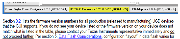

Customer is using UCD9246 and Fusion Digital Power, but Vout was not output.
I think that the reason is UCD9246 firmware version.
customer is using UCD9246 ver 5.6.0.xxxxx, but  attached document is described ver 5.7.0.11359 by page-44.
Please let me know three points below.
①If UCD9246 firmware version is old, is UCD9246 can't move normal operation?
②Is there way to update firmware (ver 5.6⇒5.7)?
 ※Or, only uninstall to install again?
③Attached document page-41 is described below, should customer contact to TI?
8422.8524.Configuration Programming of UCD Devices.pdf
Satoshi

    Additional information, customer was write incorrect file on the FUSION firmware download tool.
    After that, customer can't accsess Fusion Digital Power Designer Online.
    (When accsess the USB interface, there recognitioned "unknown device")
    I think that Firmware was disappeared because FUSION is disappear before than write.
    Customer's log is attached, is there hint of way to restore the firmware?
    ①log_firmdownlorad.txt
     ⇒Error massage when failed Firmware download

    2016/11/26 15:31:11	Error: No program flash data was found in your input. Aborting firmware download.
    The device was not modified in any way.; Please check to ensure that you have notselected a data flash file instead of a firmware image.
    This tool downloads program flash always and optionally data flash. Use the GUI's 'Firmware & Configuration Download Tool' to download a data flash image
    in batch mode or the 'Fusion Manufacturing Tool', available at http://www.ti.com/fusion-mfr-gui.

    If there information about process of way to restore, please let me know.
    Satoshi
  • Hi Satoshi,
    As it shows "unknown device", the firmware of UCD9246 should be damaged. The simplest way to solve this problem is replace it with a brand new device.
    But if customer want to recover it, they should contact TI local sales of FAE to get the correct firmware.
    Hope it could help.
    Thank you.
