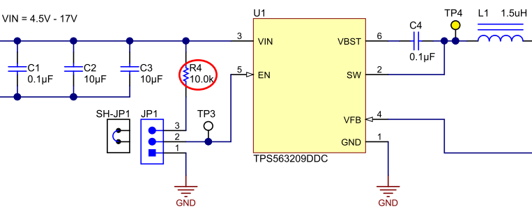

Could you tell me about EN pull up resistor?
Would you need this?
I would like to know the reason for pull up registor.
Yusuke/Japan Disty
Yusuke/Japan Disty
John-san,
Thank you for your response.
Customers are concerned about the following sentences in the data sheet.
''Enable input control. Active high and must be pulled up to enable the device.''
Because the EN terminal is pulled down,10kΩ is not strictly required.
Is my understanding of this correct?
Please tell me if there is any concern when not insert pull-up resistor.
Yusuke/Japan Disty
