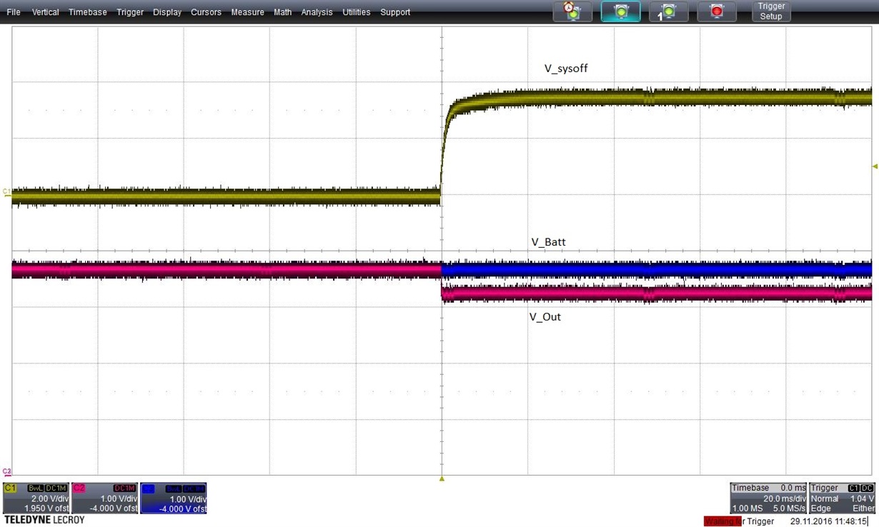

in my design the Vout (pins 10&11) cannot be disconnected from the battery.
Conditions:
V_sysoff = 3.57V (logic level active is >1.4V)
Vin - open, 0V
En1, En2, nCE = 0V (GND)
Vbat:  = 3.76V
--> Vout still drives 3.35V / 15mA
--> Vout - Vbat = 410mV
It seems as if the internal FET Q2 would have a conducting intrisic body diode... this diode is also shown on the datasheet...
