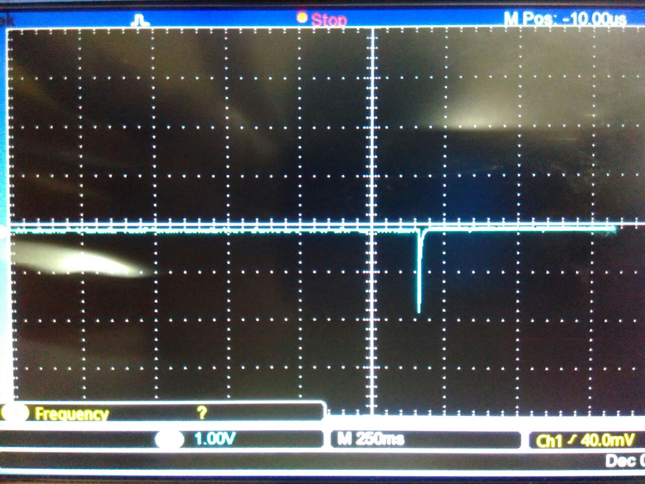

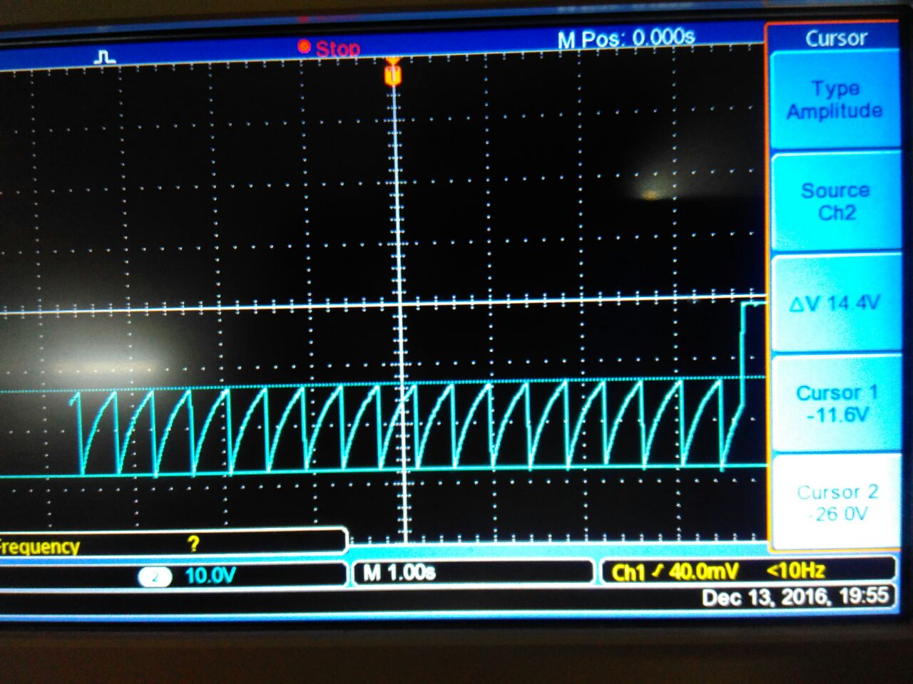

  • Hello Brigitte,
    I am facing an issue in the negative part of the power supply, the output is oscillating. The picture posted down is the VNEG voltage. The OUTN pin is always zero. I have used two 10uF capacitors in parallel for C5.
    The  VNEG was stable earlier when the VPOS was not working, so I know that the board has no issue but may be some other parameter which I am not considering
    Please help.
  • Hello Tejas,
    What do you mean with OUTN is always zero? OUTN is the switch node of the buck-boost converter, so if this is always zero, there should not be any negative voltage on the output.
    Please turn off VPOS with the ENP signal and check if the output is showing the same behavior or if it is now stable again.
    Whenever you check out a converter and see issues there, please always check the input voltage, the compensation as well as the feedback if you observe something strange.
    Brigitte
