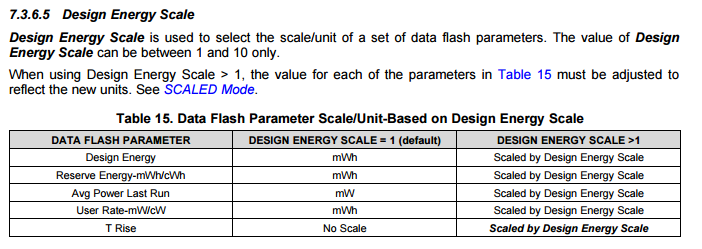

    Since I am scaling only for current, not voltage, are there any other parameters that should be scaled? It's hard to tell for sure from the wording in the docs.
    The LFP26650P pack is 8s4p, 25.6V, 10.4Ah ChemID = K2 Energy LFP26650P (0x401)
    The configuration, data, and IT parameters I use prior to scaling are:
    VOLTSEL=1
    CC gain = 1.50
    CC delta = 1.50
    Design Capacity = 10400
    Design Energy = 3.2v * 2600 = 8320
    CC Threshold = 9360
    Cell Termination Voltage = 2475
    Cell V at Charge Term = 3625
    Initial QMax0 = 10400
    Now with scaling for current, do I need to scale the current-related parameters as well or does the BQ figure it all out for me?
    Cheers! -pete
  • Hi Pete,
    You have to do design energy scale as well, since your design energy is 3.2V x 10400 > 32767. See page 31 section 7.3.6.5 Design Energy Scale in the datasheet for details.
    The other parameters look ok.
