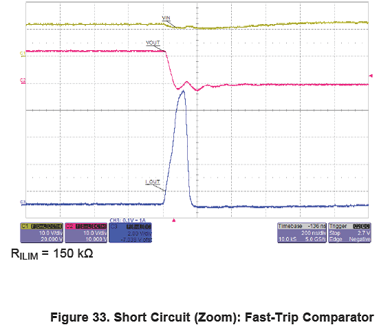

    As your Q2 reply,
    If TPS259230/40 in turn on state, but suddenly drain a big current from loading side as datasheet figure33, it seems cut off at 12A/20ns,
    How do I know this kind of load fast transient current trigger OCL or not? If 12A but only during 5ns? or 15A during 1ns? Have any specification define the trigger condition?

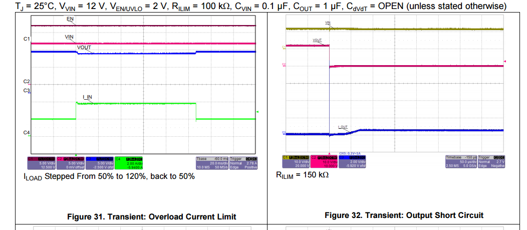

  • Hi Rakesh,
    I have another question about the datasheet figure.32, it seems already cut off, but why still have about 4A loading?
    Thanks!
    Jeff
  • Hi Jeff,
    The device incorporates fast-trip comparator to respond fast for transient short circuit events. The set threshold is at 1.6 times the current limit value. For example, if current limit is set at 5A, the fast trip comparator acts only if fasting changing load current exceeds 8A and turns OFF the internal FET in around 200ns. The trigger condition is 1.6XILIM.
    Rakesh
  • Hi Jeff,
    The fast-trip comparator turns OFF the FET immediately to avoid any damage to the device. But these spiky transient currents may not be the real faults, so the device starts in current limit mode after fast-trip cutoff.
    So, in this case, the device starts again in current limit mode and limits output current to 5A.
    Rakesh

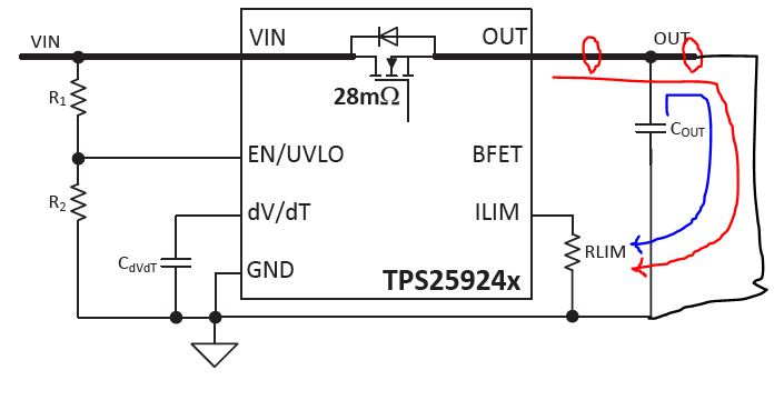

  • Hi Jeff,
    Load current measurement exactly does not reflect the switch current. When the device is turned OFF, the load current component also has output capacitor discharge current. Measuring at the points mentioned in below figure gives appropriate indication on Fast current trip threshold and response as this is the actual switch current which devices is measuring.
    Rakesh

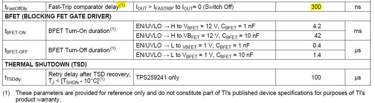

  • Hi Jeff,
    Do you want a device which auto retry for first 3 times for an OCP fault and then latch OFF if it continues to fault? If this is the requirement. Currently we do not have product to meet this behavior.
    Rakesh

  • Hi Jeff,
    The minimum current where fast-trip starts trigger is 1.6 times the set current limit value.
    As mentioned above in the application schematic, measuring the switch current provides correct information where exactly the switch is getting turned OFF. Because the peak load current magnitude and di/dt are determined by the circuit parasitics, impedance of short, capacitance at the output terminals.
    Can you please check with the customer the exact requirement and the application.
    If required we can plan to have a discussion with the customer.
    Rakesh

    TPS2592XX family of eFuses has two kind of current protection corresponding to overload condition and short circuit condition.
    Response to output overload event.
    For example, if you set RILIM = 45.3 kΩ the device sets current limit ILIM to 2.1A (typ). If load current increases but less than Fast-trip threshold (1.6*2.1 = 3.36A typ), the device will regulate the output current between 1.79A to 2.42A. If overload event still exists at the output, the device will enter into thermal shutdown.
    Response to short circuit event.
    For example, if you set RILIM = 45.3 kΩ the device sets current limit to 2.1A (typ). For a short circuit at the output, the load current increases more than Fast-trip threshold (1.6*2.1 = 3.36A typ), the fast-trip comparator acts to turn OFF the internal FET. The fast-trip comparator turn-off delay is 300ns (typical). So, in this time delay, the FET current may go even higher depending on circuit conditions.
    The FET current and Iout current are different when the device is turnoff. The output capacitor also feeds the short circuit path. so, the lout peak/duration will depend on output capacitor. Please monitor the input current or FET current to get the timing details for short circuit event.
    Rakesh

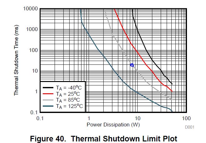

  • Hi Jeff,
    The device will enter into thermal shutdown based on the power dissipation across internal FET during overload condition.
    Let me explain with an example for overload case.
    Vin=12V, Rilim = 45.3K, Let's say you placed load resistor 4ohm which causes load current 3A at 12V output.
    Now the device tries to regulate load current to 2.1A (typical value corresponding to Rilim = 45.3K). So, Vout = 2.1A*4ohm = 8.4V
    Power dissipation across internal FET = (Vin - Vout) * Iout = (12-8.4)*2.1 = 7.56 W. Based on the below thermal shutdown plot, the device will shutdown in 20ms time.
  • Hi Jeff,
    for the above case, 20ms shutdown time is at ambient 85degC.
  • Hi Rakesh,
    So, If I meansurement as below:
    Trig OCP current = 5.46A, Vin=12V,
    Rload= 12V/5.46A= 2.197ohm, Vout = 5.1A(Rilim=150k)*2.197 = 11.2V,
    PD= (12V-11.2V) * 5.46A = 4.368W, mapping to Figure40 table, in TA=25C, it need about 2000ms = 2s to trigger thermal shutdownm, right?
    Thanks!
    Jeff
  • Correct!
    Rakesh

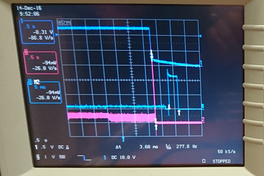

    My customer still found OCP trigger by
  • Hi Rakesh,
    My customer still found OCP trigger by below waveform, Vin= 12V, Iout= 5.56A, Rload= 12V/5.56A = 2.158ohm, Vout= 2.158ohm* 5.1A= 11V
    PD = (12V-11V) * 5.56A = 5.56W, It need 500~600ms to hit the thermal shutdown. But in below waveform, it only ~3.6ms.
    Do you have any idea about this?
    Thanks!
    Jeff

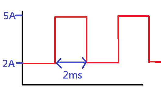

    We also try to used customer MB and EVM test as below condition:
    Load: 12V dynamic load, 2A/2ms, 5A/2ms, find it will tirgger OCP, is it make sense?
    (Due to back end device when during boot up process, average 2A loading, sometime load a peak to 5A, we found it may cause TPS259240 latched)
    If possible, could you please arrange time have a con-call with my customer? or take a business trip to Taiwan?
    Thanks!
    Jeff
