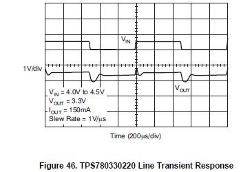

We are using TPS780330220DRVR LDO in our product as a power supply from 5 volts input .Hence I wanted to check the line regulation performance of the device. I have used Webench design for the line transient response where i got the following results corresponding to the input voltage variation of 4.5 volts to 5.5 volts which are contrary to the specification given in the datasheet.
There is a variation in output voltage of 300mV from 3.3 volts when we change the input voltage to 5.5 volts from 4.5 volts.But in your datasheet you have mentioned the line regulation ( for 150mA load current) as 1% where as in our simulation we are getting a load regulation of around (300mV/3300mV *100 = 9 %).

    The line regulation is a DC characteristic, the Vout vs. Vin is generated by a very slow sweep of Vin. Your simulation is a transient response. Based on the timescale, the switching from 4.5V to 5.5V is fast.
    Please check figure 46. from the TPS780 datasheet for the transient response:

    Thank you for clarification and I got your point . Basically you are saying to take the settled value after the Line voltage changes instead of looking at the transient response.
    In our case , It has line regulation of (20mV/ 3.30 *100 )  0.6 %  which is good and as per the specification in datasheet.
