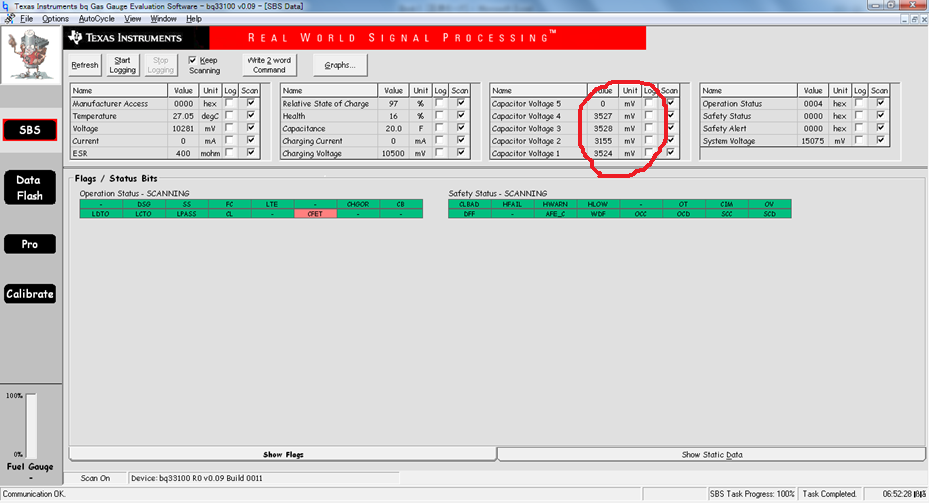

When set to 0x0208 at "OperationalCFG", indicated 4-voltages on GUI window.
Please let me know how to setting for 3-capacitors.

  • Hello Dick,
    Thank you for reply.
    Currently, I using 3 capacitors. However, GUI indicate 4 voltages.
    Do you have knowledge of this matter?
