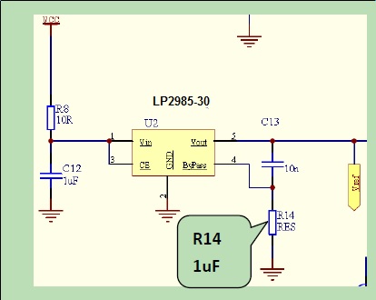

Hi Team,
My customer which is top power automation customer is using our LP2985-30, they want to double check with us that if these is some problem with their schematic and application? Pls see below schematic, customer use a 1uF cap at the R14 position. And LP2985-30 will always work at about 70C temp, will this be stable or is these any risk to use like this? Thanks a lot for your support!
If these is risk, can you help give some recommended schematic?
