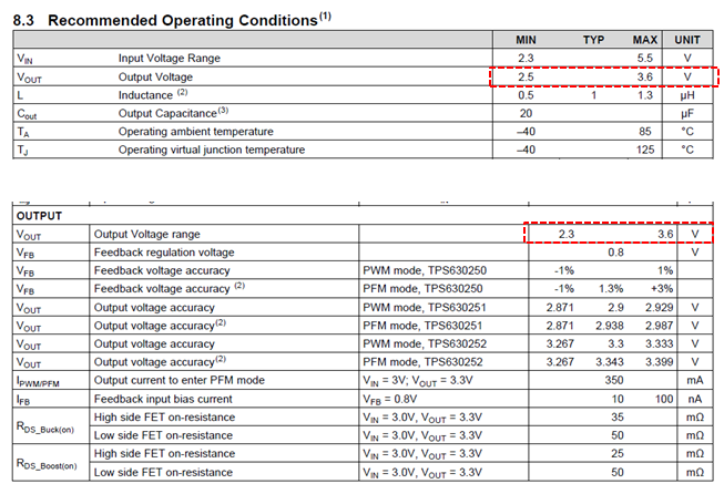

- How much is the recommended Vout range? There are different recommended ranges in datasheet. Which is correct?

Tateo-san,
please check for most current datasheet version of TPS630250 on the web, where it should be consistently 2.3V.
Please note: The device works from 2.3V, though the full output current can be get from >2.5V.

I saw current datasheet on the web. There are the different recommended Vout ranges in P4 & P5.
8.3 Recommended Operating Conditions: 2.5~3.6V
8.5 Electrical Characteristics: 2.3~3.6V
Which is correct?
tateo
Thats correct: 2.3V to 3.6V is the recommended output voltage range.
