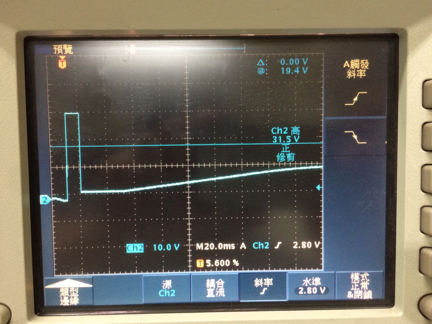

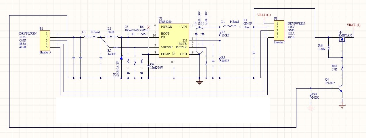

When I plug cable in system,That will 36V input to TPS54260 Vin pin but the same time Vout keep 10ms 36V also then will output 12V normal.
Is it correct? That will burn our system
Please advise.

It is not unusual to have problems with hot plugging. I don't recall seeing this before though. can you post your schematic/
I'm not seeing anything obvious. Can you post your start up waveform again including the PH node and VIN? Zoom in on the rising edge of Vout when it jumps to 36 V
It is always possible you have had a one - of failure. If you can duplicate it, please post your waveforms.
