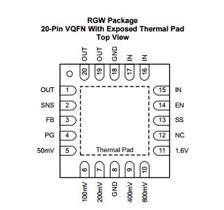

Hello, I am currently troubleshooting a design centered around the TPS7A7300.
My reference datasheet is Rev.E (Dec 2015)
By looking at the several figures, I notice that the pin 1 marker (circle) is situated near the "IN" pins on pages 11-18. On Page 3 and in pin configuration, the marker is between the "OUT" pins (pin 1).
Is the page 3 configuration the correct one?
Also, on page 3 and on the eval module (SLAU430, dec 2012), EN is situated on pin 14 and SS on pin 13 . They are swapped on figure 43, page 25 of the device datasheet. Can I assume again that the (page 3) datasheet pin out is the correct one?

  • Hi Ludovic,
    The Pin Configurations section on page 3 of the datasheet is correct.  Thank you for pointing out the inconsistencies.
    The pinout of the TPS7A7300 has been the same since it released.
