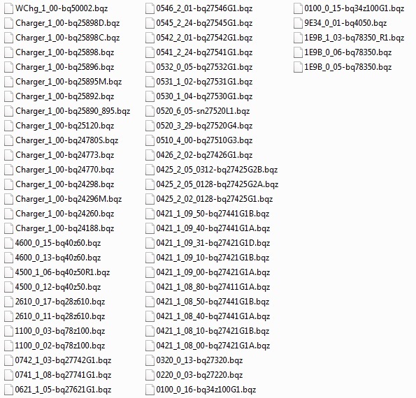

Current issue is that the the" BQ35100" is not listed in the BQStudio. I am using the EV2300 and the BQStudio auto detected the connected device as "0100_1_02" and this is not in the list of profiles available.
I selected the "0100_0_15" BQ34z100G1 which seem closest. and interestingly it shows all the registers.

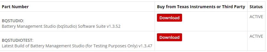

BQStudio Version :  1.3.52 (Aprin 14,2016)
The BQ35100 seems to be released somewhere around August 2016
