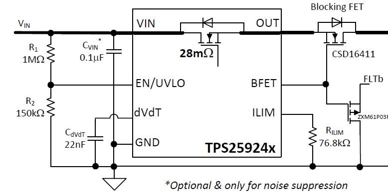

Do we have a solution that can replace this relay:
The switch needs to be bidirectional and handle 1A of current.

We have TPS25924 with external blocking FET solution to meet this requirement. When enabled it can support bidirectional current flow and can blocks bidirectional currents when disabled. But the device needs power from Vin for internal circuitry. i.e, to start the device Vin has to be available. Please check.
