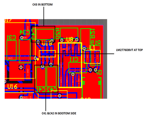

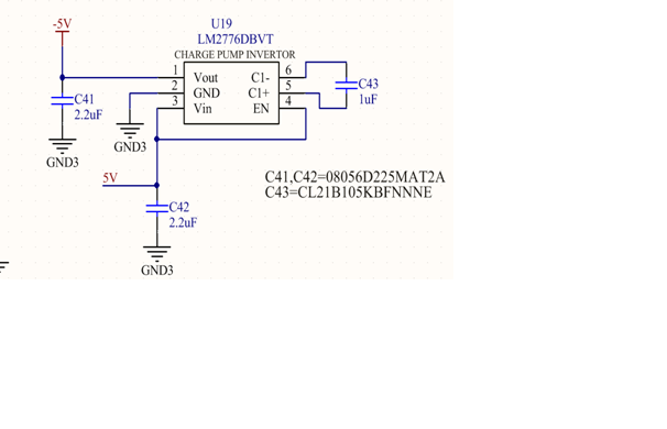

I am having an issue with a prototype design with the LM2776. I have followed the suggested layout and component suggestions, but when I look at the output without a load, the output is -1.2V and not -5V (VIN is 5V) .
Any help or suggestions would be greatly appreciated.
Schematic:
