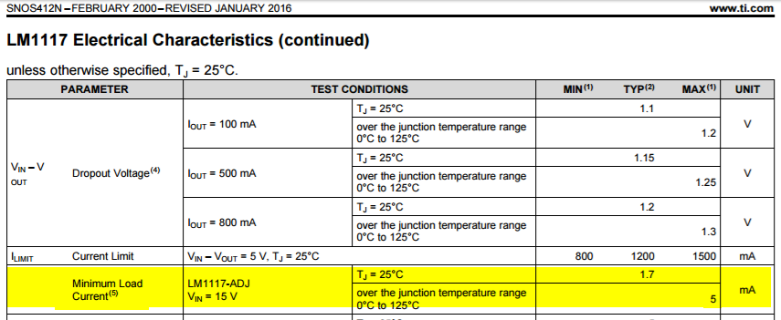

Dear TI-Team,
Please can you tell me whether LM1117SX-5.0 must have a minimum load current for stable Vout regulation in case of Vin=15V ?
According "Load Regulation" Vout varies from app. 1 to 20mV at Vin=6.5V. I am going to use Vin=15V.
Is the output stable in case of Vin=15V if there is no load at the output of fixed regulator LM1117SX-5.0 ?
Gerd
