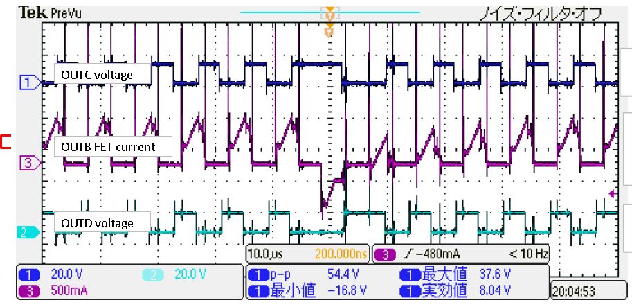

Following wrong waveforms are observed on the my customer's circuit.
Followings are another information;
- Frequency of this error working is increase as load power.
  And it also depends on the resistor during TMIN pin and GND.
  Frequency increases the more the resistance is large.
- Waveform of OUTA/B is correct.
Could you tell me the reason of this error working and corresponding?
