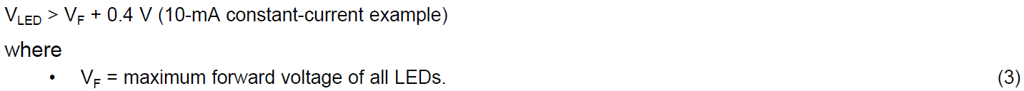

    Has your problem solved now? according to your description, what's the max forward voltage of all the 5 series of LEDs @ Io=20mA?
    As for the appropriate LED supply voltage, please see below:
