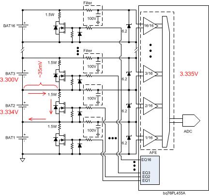

1、the cell's voltage will be changed when i turn  on the balanced switch  and  there was a beat voltage with 5mV ~ 20mV  on the next battary?
for example
the cell n's normal volt is  3450mv ,the cell n's volt will be  up to about 3456 ~3460mv  when i turn on EQ(n-1)
why so?

    1. If there is a shared connection to the cell for both VSENSE and balancing, then this is expected. The balance current will cause an offset due to the current over the shared path of the cell connection (on-board traces, connector and wire harness).

    1. You can, but most do not as this will now mean double the number of connector pins and wires to connect the cells. These connectors and wires are very expensive. It is expected (just ohm's law) that there will be an offset due to the balance current over the shared connection, so it usually just compensated for in the MCU algorithm.

    i think the balancing is abnormal,because the cell voltage will be up when i start the bancing and voltage will be abnormal when i stop balancing,
    for example the 3th cell's normal volt is 3340mV,and the fourth cell's volt is 3300;when i start the balancing for the 3th cell,and the fourth cell's volt will be high(3350mv) ;but the fourth cell 's volt will be ok(3300mV) when stop balancing ;and the sampled data is wrong when balancing
    so How can I solve this problem?  start the balancing ,i would never be able to find  the max cell or min cell

    What you are seeing is simply from ohm's law. I have created a drawing below to try to explain why you are seeing the extra offset on the adjacent channel. It is expected, and can in fact be calculated in your code to remove the offset if necessary. The current is known (balance current = measured cell voltage before balancing / sum of balance resistor and EQ FET Rdson. Your cell connection harness and connector contact impedance x the balance current is the source of the offset.

    turn on EQ2 as your drawing ,Bat3 is +35mV not -35mV on my side,and so this is my question . and bat2 less than -35mv is normal,

    I believe that there is a small understanding with regards to your first question. With Stephens explanation, Bat3 would measure +35mV higher than before. The voltage measurement is differential, so moving the bottom reference down would increase the overall voltage reading.

    As Stephen mentioned in a previous post, this offset is something that can be calculated in your firmware. In the code, you can then do something along the lines of:
    Vcell(actual) = Vcell-Voffset
    in your code. You would use that formula only when measuring the cells you are balancing, and a normal formula all other times.
