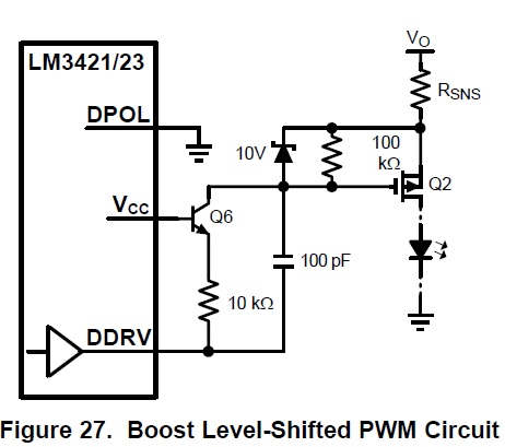

Is PMOS dimming possible with below circuit at LM3423 Buck-boost as well?
Hello David,
It should work just fine for buck-boost as well. You can refer to the buck-boost schematic in the TPS92691 datasheet for another way to do PMOS dimming as well. Either method should work.
