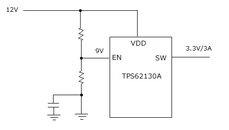

I want to control enable with the following circuit.
How much resistance and capacitor should I use?

  • Seishin-san,
    the total resistance is recommended to be in the range of 120k to 1.2M, which consumes a current of about 100uA or 10uA.
    Basically it can be lower, but would just consume more current. Example: 60k/180k with 50uA
    The capacitor might not make any sense in this configuration. What is the purpose of it?

  • Hi Seishin,
    Could you please explain what do you want to achieve with this circuit in more detail?
    There are devices which implements a precise enable pin like the TPS62135.
