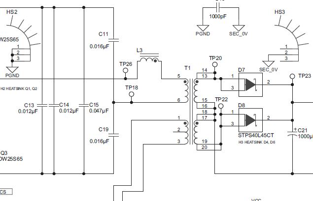

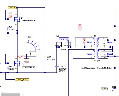

  •  Which schematic to refer.??
  • Check above 2 circuits.. where almost capacitors position are different.. and what the Cr in the circuit both circuit..??
  • Hello Deepak
    Cr is C39 in the first circuit, Cr is the parallel combination of C19 and C11 in the second circuit. Either circuit will work and further information is in section 8.2.2.16 of the UCC29950 data sheet.

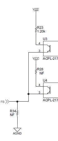

  • FB pin programs a certain frequency at the GDx pins..??
    What is GDx..??
    if you look at the schematic..
    Aplly KVL,
    +VCC-Vce(on)-I(1.2K+3.32K)=0
    So,Current flowing through the Loop will be i=2.6mA
    So,voltage drop across 3.32 (FB Pin)=2.6mA*3.32K=8.7V
    What calculations are you doing or giving..??

    How did you model the opto's in your KVL equation? The opto's are controlled current sources.
  • Hi Brian,
    I am considering it as Transistor model, cant we apply a KVL there..?? i dont know exactly..??
    it is related with the CTR something..??
    What equation will be at transistor side..?

    GDx is a short form for the signals GD1 and GD2.
    So,voltage drop across 3.32 (FB Pin)=2.6mA*3.32K=8.7V - this is the maximum voltage at the FB pin with these resistor values and assumes that the phototransistor is saturated. As you know, the FB pin control range is VFB(min) (170mV) to VFB(max) (3.88V) so we can comfortably exceed VFB(max) with these resistors. The current in the phototransistor when the FB pin is at VFB(min) is 51uA (170mV in a 3.32k resistor). This is reasonable - but you should double check the phototransistor leakage current at high temperature when the LED current is at zero and maybe reduce the 3.32k value if necessary. The important thing here is that the emitter of the phototransistor has enough operating range to set the FB pin at any voltage in the range between VFB(min) and VFB(max). So the phototransistor current has to cover the range 2.6mA to 50uA. The phototransistor current is simply the LED current multiplied by the CTR and it is easy then to calculate the LED currents needed to give the phototransistor currents. A slight complication is that the CTR is a function of the LED forward current and of temperature - so you need to calculate the required LED currents with this in mind and also with the part to part CTR variations that you will get. It is also true that the CTR of all optocouplers degrades with time - I've never been able to get a quantitative description of this degradation but the rule of thumb is to assume that it can halve over the product lifetime. You will also need to do the calculations with this factored in.
    So, you should be able to calculate minimum and maximum values of LED current. This allows you to select the operating current for the TL431. Note that it is usual to include a resistor in parallel with the LED. This provides a path for the minimum Ik of the TL431. The resistor should pass the minimum Ik with a voltage drop less than the Vf of the LED - for example we have used a 10k resistor to pass 100uA at 1V. You may want to use a lower value resistor - it depends on the minimum Ik of the TL431 you are using.
    Now, can you use PC817 instead of the ACPL device ?. There are two considerations here. First, from a technical point of view there is no problem using a different optocoupler, you just need to do the calculations based on the device parameters given in the data sheet. Second - and more importantly - the optocoupler crosses the safety isolation barrier and you must make sure that any part you choose to use (including the ACPL device) meets the safety isolation standards that you require. TI can't offer you any advice on this safety related issue and I'd suggest that you get advice from your safety approvals experts before making a final selection.

    The optocoupler is a current controlled device, look at figure 3 in the following link: powerelectronics.com/.../Kollman and Betten September 2003.pdf
