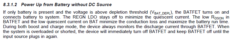

VSYS short test, Is BQ24295 no protection function??
Could you please help to reply protection action.
1.When VBUS only (without Battery) , Short Vsys to gnd.
BQ24295 will input limit, Right??
2.When BAT only (without USB input) , Short Vsys to gnd
What's protection action??
3.When VBUS+BAT , Charge mode. Short Vsys to gnd
4. As SPEC has description,When sys pin short or over load,Internal BATFET will turn off,What kind of condition for entering this protection step??
