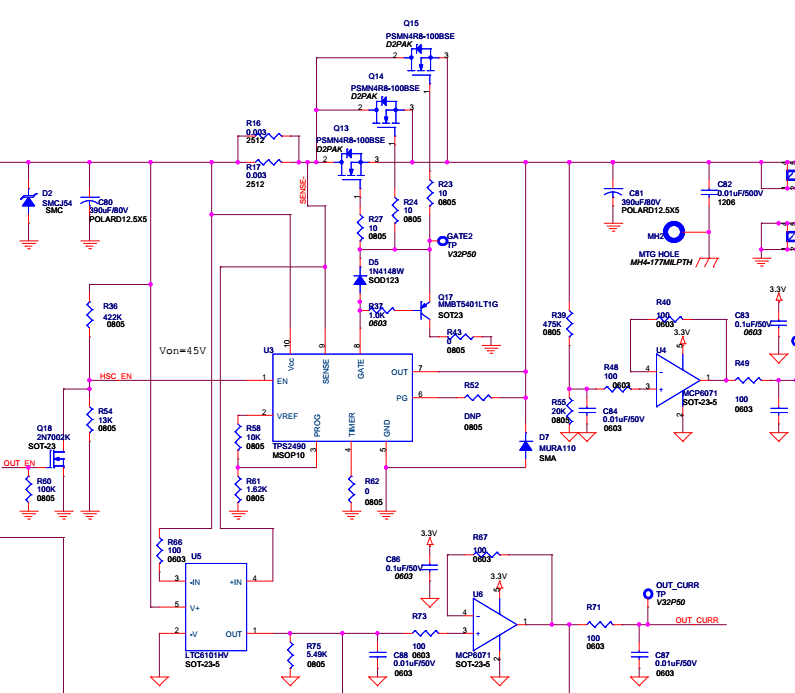

I am using TPS2490 driving three MOSFETs in parallel at the output of a DC/DC converter (30V).
I measured the current drawn by the TPS2490 circuit when EN pin is held low (0V) and it is around 500uA, while the datasheet says 90uA typ and 250uA max.
Why the higher supply current when in shutdown mode?

    I measured the current by eliminating and taking into account all other circuits connected. I am using TPS2490 to disconnect the output of my boost converter from the load.
    When the input voltage is applied, but the converter disabled, TPS2490 is in UVLO and blocks the input voltage from the output. In that case, the Vcc and SENSE pins are at 25V, while the OUT pin is at 0V. In that situation my estimate is that TPS2490 draws around 500uA, which is higher than the spec in the datasheet.

  • Hi Aramis,
    See below the section utilizing TPS2490 controller. The CSA U5 has been removed for the test.
  • Hi Kiril,
    Thank you for the screenshot of your schematic. I went ahead and measured the current on an EVM board, and it was around 125uA (within the specs). I believe I know why you're measuring 500uA of current. There are two current paths to ground that might be adding up to 500uA.
    1) When the FET (Q18) is turned on, there's current flowing through R36 to GND. This produces an extra 45V / 422kohms = 107uA.
    2) When VCC is powered, the 4V regulator at the VREF pin is activated (even with enable low). The amount of current flowing through R58 and R61 is 4V / 11.62kohms = 344uA.
    If you would like to decrease the current from 2), increase the resistance values of R58 and R61 by 10x.  If you would like to also decrease the current from 1), increase the resistance value to around 2Mohms. I hope this helps.

  • Thanks, Aramis!
    I assumed that the reference is off, and I think I even measured it to be off, but I just verified that it is on when the controller is disabled.
    Thanks for the suggestions.
