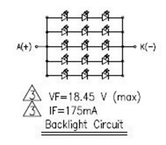

HI Sirs:

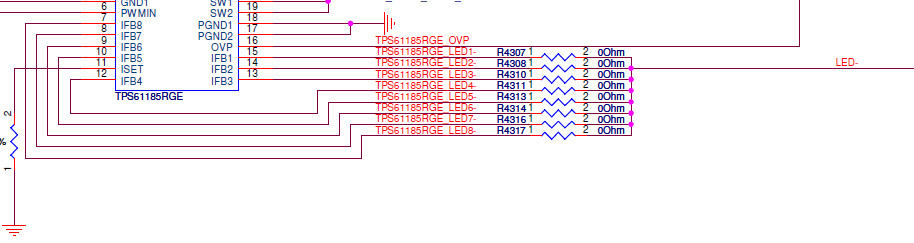

Our customer change backlight LED to this type, which seams like 1 string but need 175mA,
Can I connect IFB1~IFB8 together then connect to K(-)?

Hi Logan,

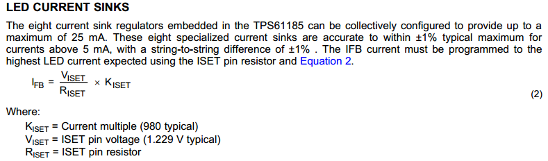

I think it's OK because TPS61185 supports up to 200mA (200 = 8 x 25 mA) but need to do double-check.
To support 175mA, max IFB of each channel should be 22mA (22 = 175 / 8). IFB can be calculated from the equation below. It depends on the value of RISET. Please check this value to get the IFB value.
