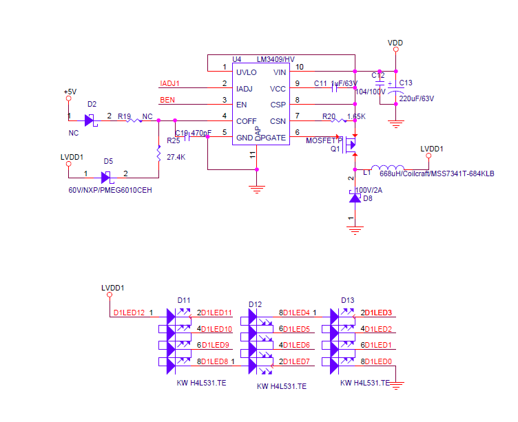

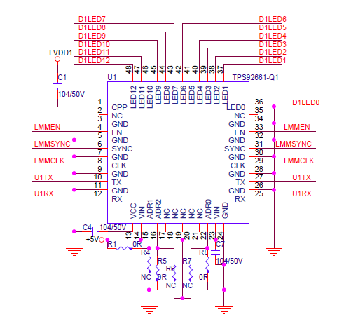

  • Hi Mike,
    I meet a LM3409+TPS92661 issue now.
    I just clarify LED Vf with customer, Vf = 3V, and schematic as below, Could you please help us to review below schematic,
    We already move R20 to current path, and change value to 1.65ohm, but seems still not work.
    Even TPS92661 not work, defult register let all 12 pcs LED turn on? or it default off, bypass by internal MOSFET, need setup register to turn on?
    If need setup register first? What address and value need write to register?
    , KW H4L531.TE - Oslon Black Flat.pdf
    Thanks!
