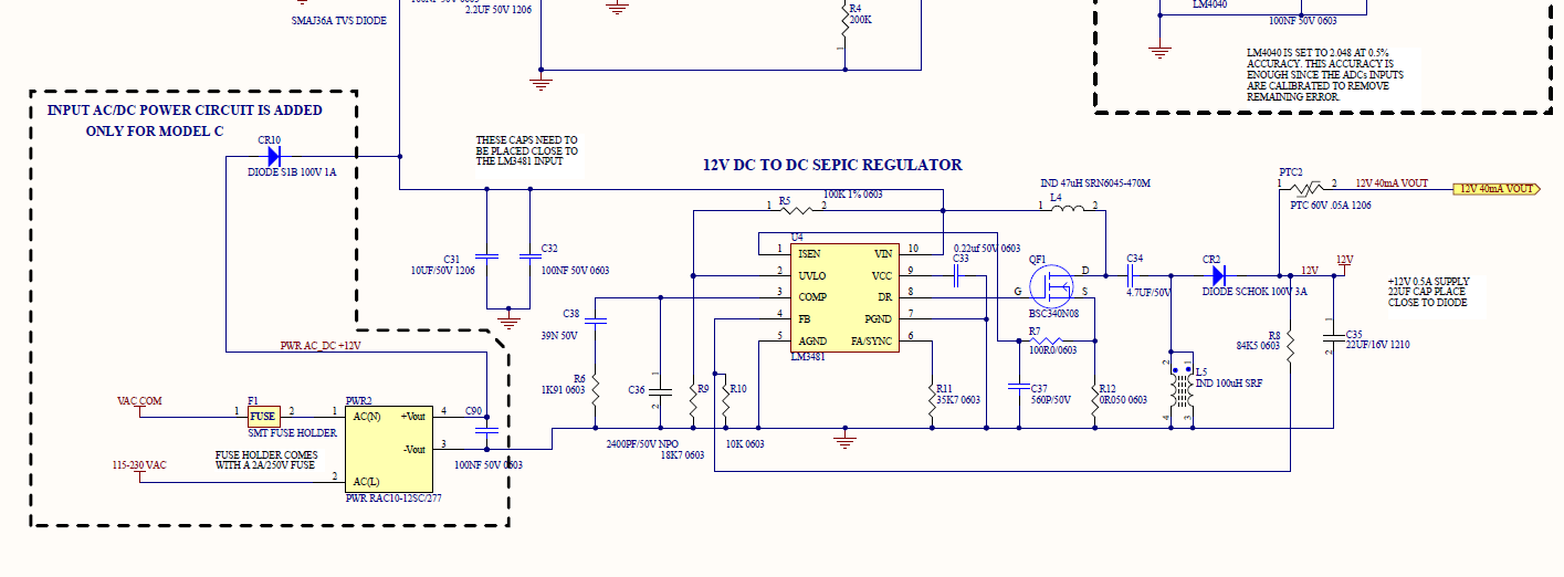

Hi Ambreesh,
Thanks for your support. Below is the schematic . I am using the coupled inductor. I do not want to use the shield . do you have any other solution.

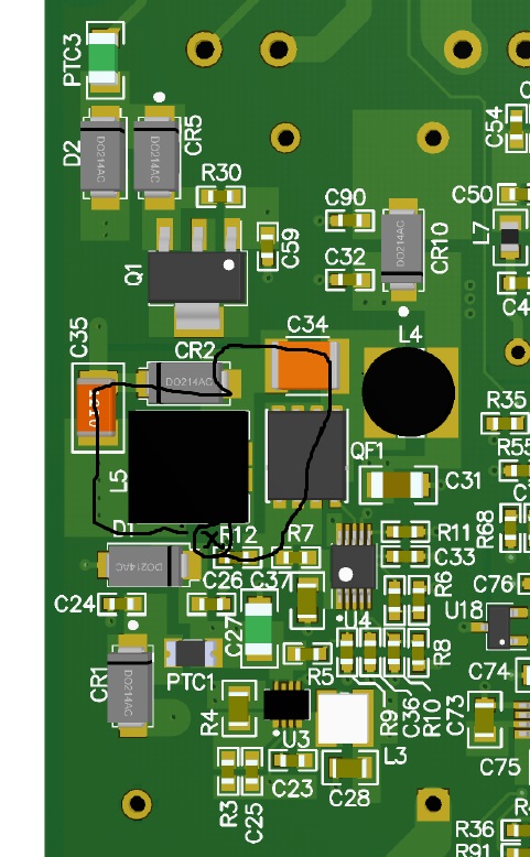

To further debug the issue , can you please also post your Layout as well as radiated emission test results .

Thanks Dileep for sharing the details of your design .
Below are some points on Schematic ,layout and the ways you can debug the radiated EMI issue .
Schematic:
Can you please let me know why are you using both an uncoupled inductor L4 and a coupled inductor L5 in your design ? You can easily get 100UH 1A inductor in much smaller size and replace L5 or use coupled inductor and replace L4 and L5 .For more details , please refer to below links:
Layout :

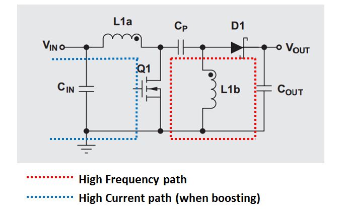

The hot loop in SEPIC is high frequency switch current path as indicated below by red trace
In your case that path is obstructed at the current sense resistance to ground to output cap ground .You could have easily connected them together .
Further HF decoupling cap should be place closer to VIN as well as Vcc pins of LM3481 .Please follow the layout example of PMP10610

1. Remove coupled inductor L5 and place a shielded 100uH, 1A inductor .
2. Connect R12 ground directly to inductor ground .
