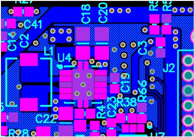

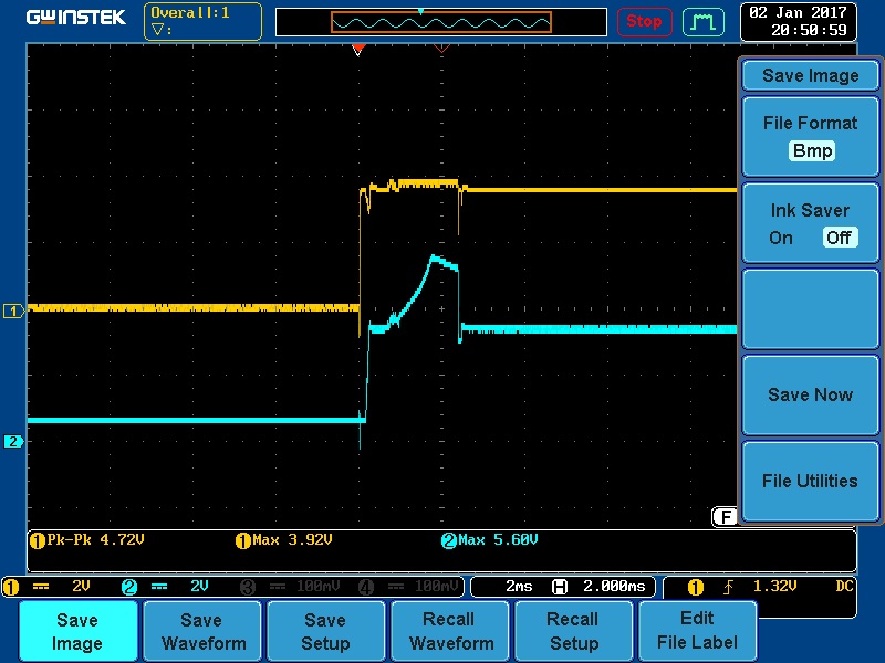

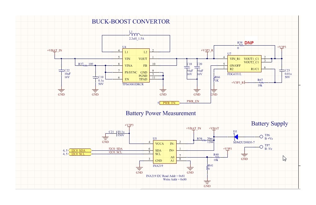

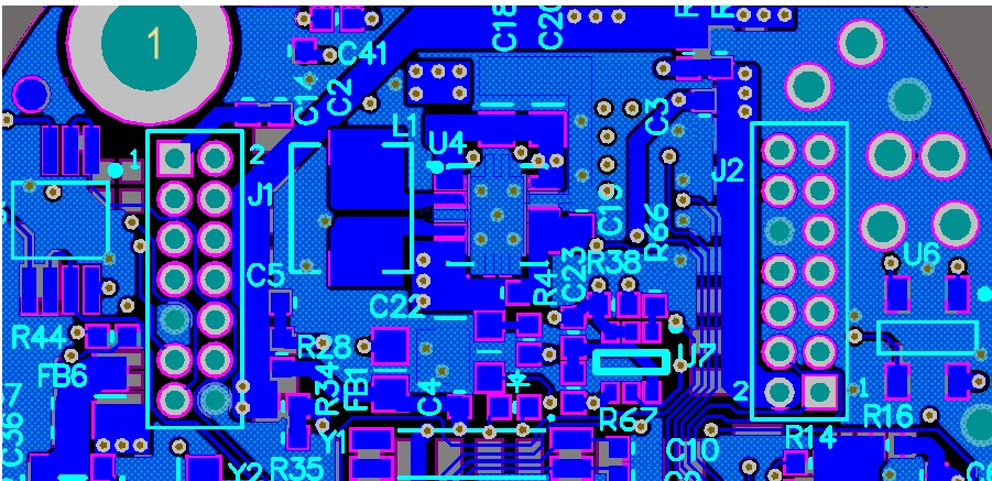

I am using TPS63001 in my design. When I got assembled board. First time power on I was getting 3.3V. then onwards it is started loading.
Inductor and GND is showing short. I do not what is the issues. Can any one help me on that. please find the schematic below
